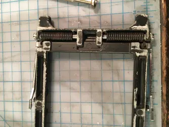

So the madness began this evening, the back is where the corrosion is (its most surface and superficial) but still needs to be tended to. Due to where it sits it would prevent the film back from seating properly so it needs to be removed before even attempting a shot.
Fist order of business is removing the whole back assembly and prepping it to be cleaned.
Some sanding ensued but the spring arms were giving me trouble as they are a bit bent so I made the mistake of popping one out to bend back. It took a half hour and some yelling to properly depress the spring to get it back into place.
Due to the frustration of this job and the fact its holding better I may not tend to the other side just yet. Its hard to tell but its back to the shape it should be. These arms appear to be out of some kind of weak metal and seem easily damaged.
The sanding revealed some nice metal beneath, I will heading to the hardware store tomorrow to get some paint stripper and matte black paint to refinish it with. We shall see how it comes out.

All-in-all the damage is more or less superficial and its looking good so far. There seems to be a back and a lot of parts up for sale on the bay should something go terribly wrong. Since I only ever intend on using it with in-lens shutter style lenses I am going to leave the body shutter alone for now.

I was able to strip off all the old paint, it took 4 shots of paint remover as well as a lot of steel work. I used some flat black primer to re-coat it and it came out pretty nice.
