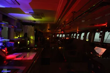

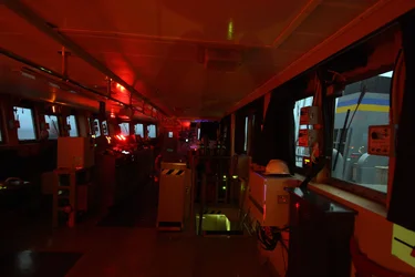

I have been experimenting with my wide angle lens on my ship lately and noticed red spots in the photos. The photos ranged from 1 min to 20 minutes. Everyone has had red spots in the photo. I varied the ISO from 1600-400, and that seemed to help a bit, but I see they are definitely there on the lower ISO.
I noticed spots a few months ago on another time lapse photo I took, but I thought it had something to do with the fully manual wide angle lens I was using. This is a new lens, and I see I still have the problem.
Any suggestions?
Please post an example.
I think you are seeing image noise caused by high ISO, plus in the case of long exposures, thermal noise from the image sensor heating up.
Your camera may have a Long Exposure Noise Reduction (LENR) option. If it does you need to know that if you take a 1 minuter exposure the LENR will make a 1 minute exposure with the shutter closed so the image processor can map and remove shot and thermal noise from the image. By the same token if you make a 17 minute exposure, the LENR feature will also make a 17 minute exposure.
Another way to minimize image noise is to make a lot of much shorter exposures and 'stack' them post process. Photo Stacking and Long Exposures - Part 1: Introduction | Shutter Photo Magazine
Thanks so much for your help. I have used the feature in the past, but hated when it took an hour to process a half hour time lapse. Now I understand what was happening when I selected that option. Maybe it's time I bought a second body to do more than a few photos a night.
Here are the photos I was talking about. Sorry it took so long, I am on a ship and our internet is a bit slow.
