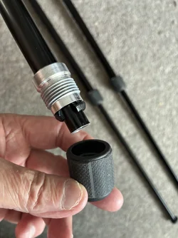

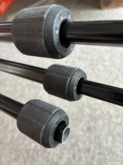

Hi, all! newbie here, so I hope I've chosen the right sub-group for posting a question.
In late 2024 I bought a Joby Rangepod tripod - not an expensive bit of kit, but would suit me, I thought, for the very occasional use I'd put it to. Probably only dug it out a handful of times when I used it the other day, and it looks in pristine condition. Now the problem.... one of the twistlock sections froze completely. The locking nut unscrewed completely from the fitting and the leg wouldn't budge. (I contacted Joby, who were extremely unhelpful, but that's a matter for them and the Trustpilot review I've given them!)
I've managed to push the stuck section back in - plenty of friction to overcome -so it's now frozen in the retracted rather than extended position. Surely I can't be the first person this has happened to? That's one of the questions I put to Joby, which they studiously ignored!
Hopefully the attached pics will help to clarify the issue. You'll see it's the thinnest, bottom section that's the problem. I removed the rubber end cap from the foot.
Hoping someone here has a better idea than the manufacturer as to how to rectify the problem!

It may be that some debris has gotten inside the tube. Perhaps some penetrating oil (I don't know if it is called something different in GB) or some light heat (blow dryer on high setting applied to the tube will help loosen it. If you can pull the inner tube out and wipe it down.
WD40 should do.

Can you purchase WD-40 in your country? If so that will get the leg loose, leave the collar off with the leg upside down, then spray WD-40 on the smaller tube and let it soak inside between the tubes, wait a few hours and apply a little more, then let it sit over night.
The next day flip the tripod over hold the foot to the floor with your feet and pull upward, hopefully the tube will slide out a little.
Slide it back half of what it pulled out and repeat the WD-40 application, then repeat the pullout.
Eventually you will get it all the way out, wipe it clean with mineral spirits removing as much of the WD-40 as possible, you don't want to leave any in place as it will attract dust and dirt.
After all that slide all the legs out and thoroughly lubricate them with dry silicone spray.
It looks to me part of the compression sleeve has broken off and gone down between the leg sections. If that is the case it's a matter of pulling and twisting until you can pull the sleve out. Sounds like you probably will not be able to buy a replacement part if they will not answer customer service questions.
