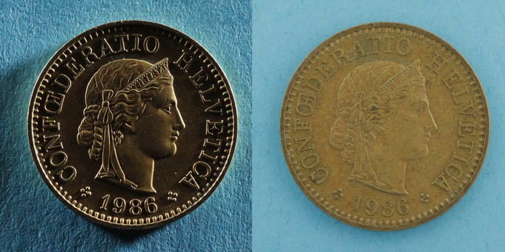

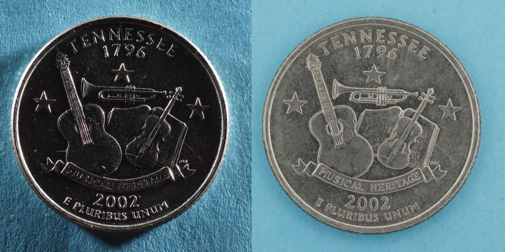

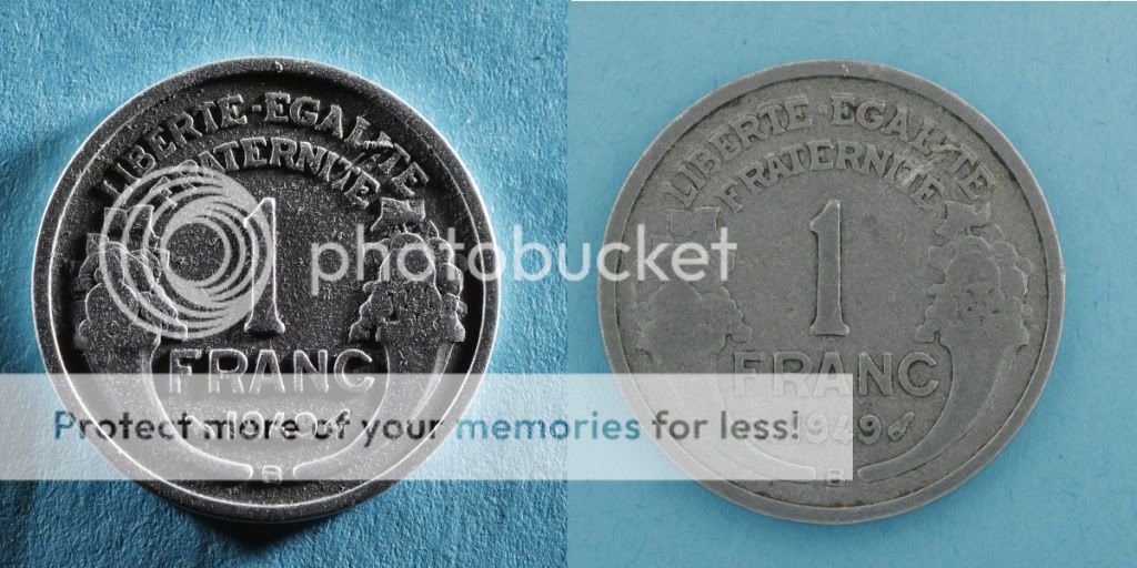

Did you see pgriz's post a while back on lighting + coin? It was a great set also, this is what your picture reminded me of...
These were taken with a Tamrom 90mm macro, with two flashes in manual mode arrayed at the 10 and 2 o'clock positions, with the flash heads at the same level as the coins (ie, very low). The left side is showing direct flash, and the right side is exactly the same, but with a diffuser that provided more omni-directional light. The level of detail is exactly the same in each set, but the angle of light makes a very big difference in the overall appearance.
This experiment also shows that there is not just one "best" way to use the light, as the quarter shows better detail and definition in the omni-directional light version.
For those who care about these things, ISO=100, f/8 and 1/180 sec, 90mm focused at the closest distance (1:1).
Oh, and yes, I've violated the rule of thirds. ;)
