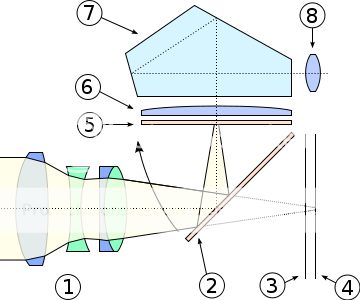

When you look in the viewfinder the lens is kept wide open so the viewfinder is a bright as possible.
When the shutter is released, or a DOF preview button is pressed, THEN the lens aperture is physically set by the camera.
At any rate the light path to get the scene up to the eye is different than the light path to the image sensor.
Additionally, the image sensor doesn't work like your eye does.
Cross-section view of DSLR system:
  1. 4-element lens
  2. Reflex mirror
  3. Focal-plane shutter
  4. Image sensor
  5. Matte focusing screen
  6. Condenser lens
  7. Pentaprism or Pentamirror
  8. Eyepiece
