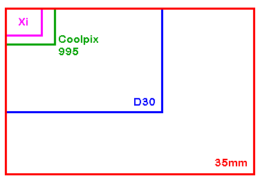

A 10mpx camera is a 10mpx camera if the correct lens projects a sharp picture onto the sensor.
That's news to me. The pixels are different sizes. That's like saying a disk film camera photo has the same quality as a 35mm shot, with the same film, made into a 4x6 print. They are not the same.
Smaller 7mp sensor, on a P&S means smaller pixels, if the same number are on the larger 7mp sensor of a DSLR.
When you make the smaller pixels larger, you lose.
Try reading this.
http://www.cambridgeincolour.com/tutorials/digital-camera-sensor-size.htm
Your choice of sensor size is analogous to choosing between 35 mm, medium format and large format film cameras-- with a few notable differences unique to digital technology.
"bigger is better" when it comes to image quality and digital sensors.
