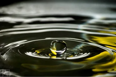

Hi all this is my third go at some water droplet photography. Pretty basic setup with a plastic bag dripping into pan. Camera setup is Tokina 100mm macro with off camera sb400 flash. Still need to work on DOF but thought they were on the right track. Would love some C&C or tips. Thanks.
PS quality not that good I had to download from Facebook onto phone instead of direct upload.

Good start, took me at least 5 attempts to similar results. I was going around the whole process badly but such is life.
Try getting a multi-colored background and shoot the flash at that instead of the droplet normally adds some color to the droplet and surrounding water, also I have found darker dishes / pans are better than light ones.

Thank you. I was firing the flash all over the place haha just trying to see the different results. I will try the dark pan, most of the tutorials I see use them too. This was just with a white baking pan and the results weren't exactly what I was hoping for.
I tried looking at the link, but couldn't click on the individual photos. Were those your 3 droplets that almost looked like umbrellas ? Very cool if they were. Any tips to get that affect ? Most of mine are just the big drops or the splash variety.

To get the umbrella looking ones you will need to increase the drop rate. I use a medical pipet to get my drops, found that way you can increase drop rate. Try using milk as well the thicker liquids can be a little more easier to work with than water. Also play around with food coloring can get some interesting effects. I also watched and read god knows how many tutorials and even tho I took away something from every one of them in the end I found it far more satisfying to just play around and learn as I go. If you have the money you can buy proper equipment for this sort of photography but you will be spending around 400+USD for it. Attempted to beg the wife for one but lost the battle . . . for now ;)
If you can get colored plastics instead of papers as they obviously reflect the colors better.
The collisions (umbrellas) took me roughly 300 shots to capture and found that milk was better for that purpose alone, I generally put my camera on a two second timer and once the last beep goes I start squirting liquid from the pipet. will need roughly 10 drops a second give or take (not an exact science) to capture a collision. Gels over the flash can add a lot of color as well.
Awesome man thank you for all that info. I don't see me having any luck convincing my woman to spend that kinda money so I can drop water into a pan either haha. So ill stick with improvising. Kinda more fun that way, in a way.

Thanks for the compliments guys. I liked the orange one best too I think. It came about the time I started playing with my flash and actually saw some progress with reflection of the background in the water. I too like the bigger droplets usually but kinda liked the black hole swallowing the tiny drop with this one.
Will hopefully find some time this week to give it another go with a better setup using some of the tips given in this thread.
And yes I was using continuous shutter. Wish I was good enough to time it but these things are tricky. And my setup is definitely less than optimal. So I took the blind fire approach haha. Which can actually be more fun as you really don't know what exactly you've got until you go to process.
