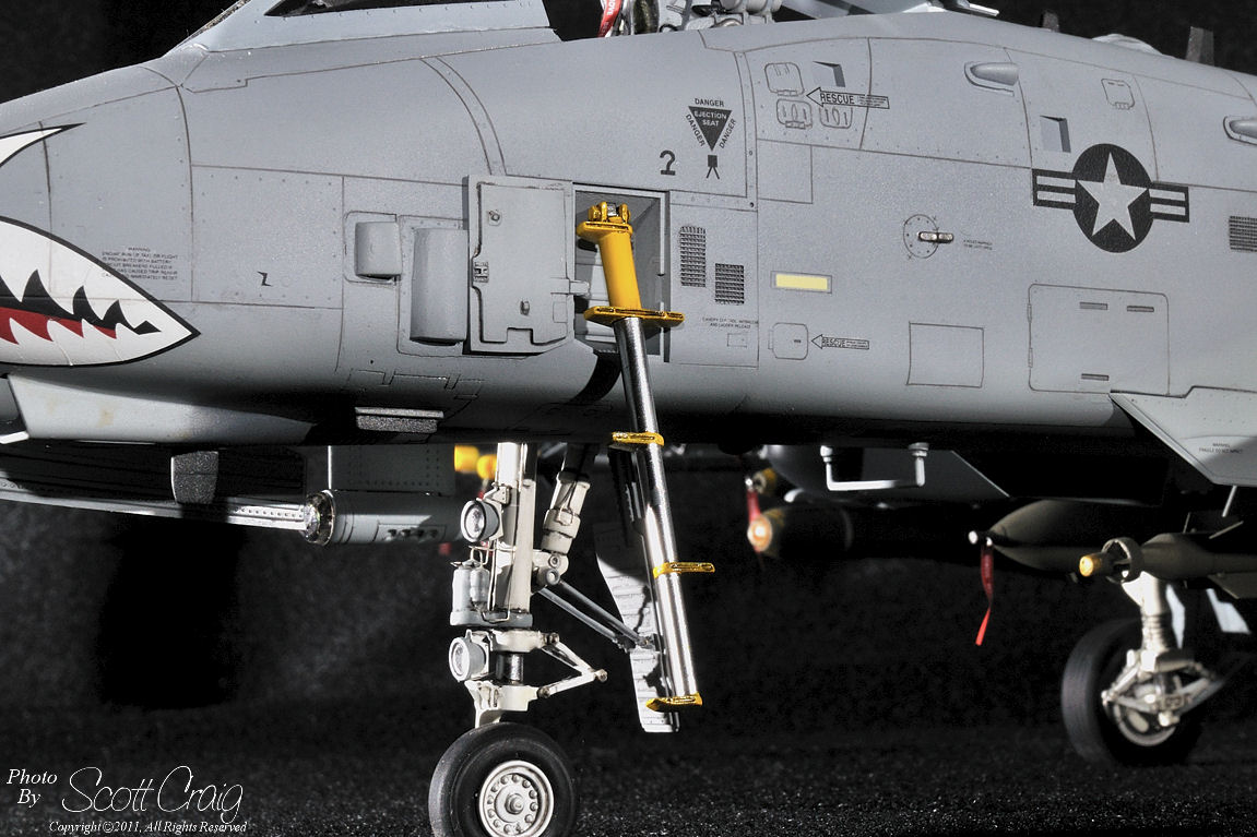

Detailed as in:

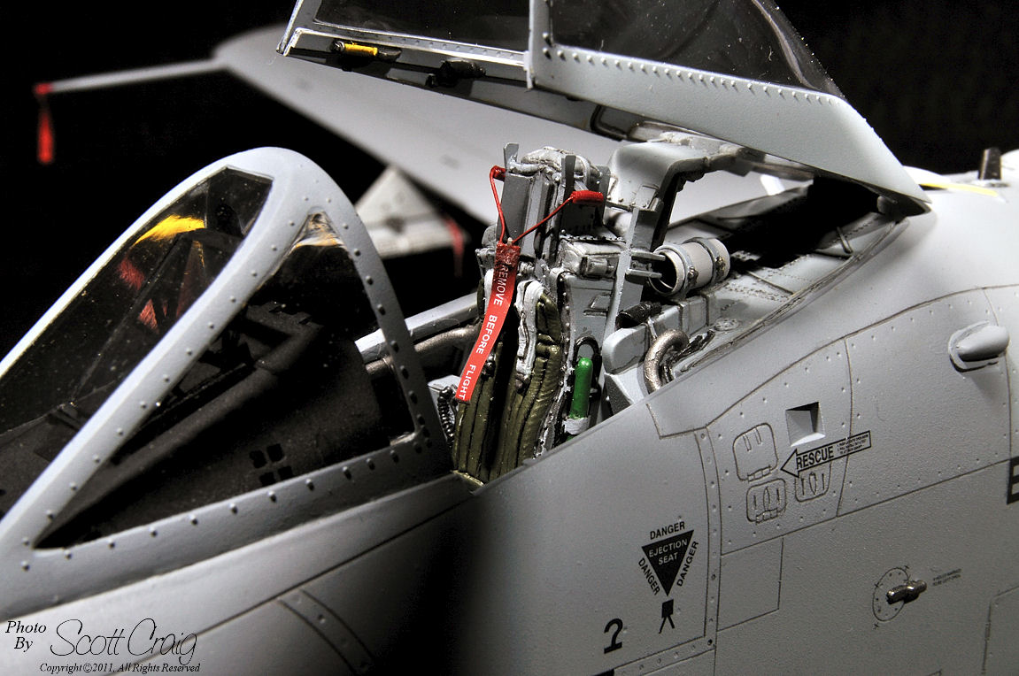

or
This is a 1/32 scale airplane and that red "Remove Before Flight" streamer is about 1/8" across. The nose wheel is about a half inch in diameter.
Any DSLR can do what you want, it's the lenses that make the difference. For close work you need a macro lens or extension tubes and some lights. For vacation shots a more versatile lens like a 17-70 zoom. Or you can get one that combines both.
Yes like that! But does it also provide video quality like that?
