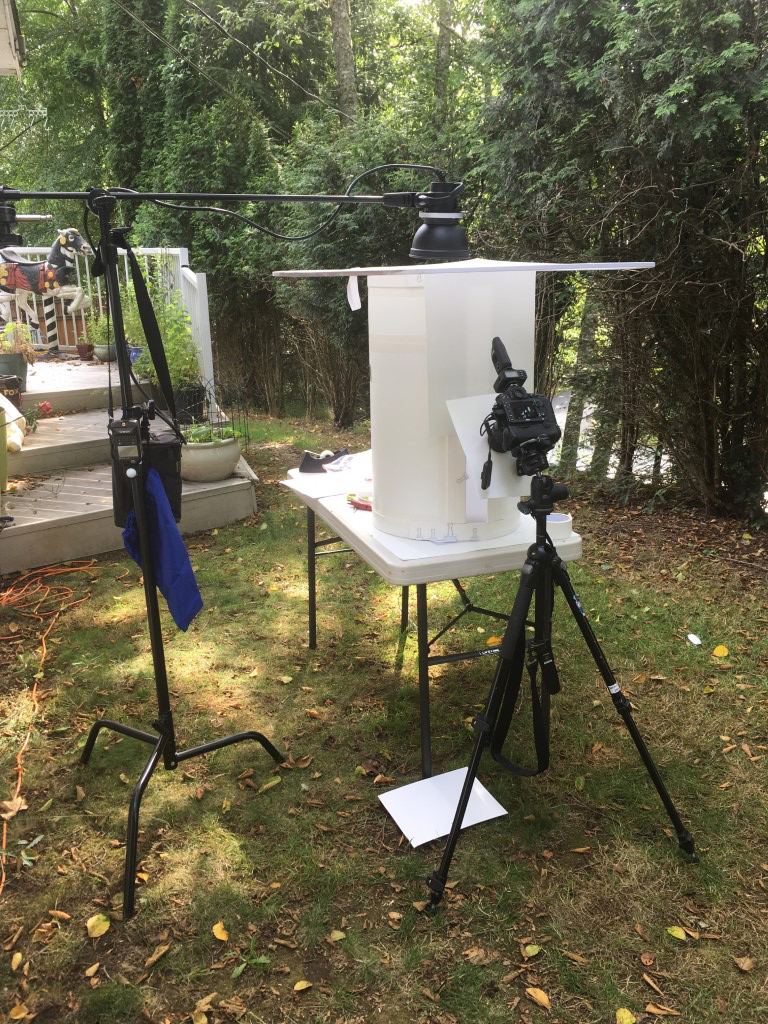

It's my home-brew set up for shooting sterling silver on white. I recently picked up a fairly lucrative, on-going job with a local jewelry maker, and one of the tasks is shooting her sterling silver line on pure white for on-line sales. This is NOT the easiest thing to do as controlling reflections is a <female dog>, so the best approach is to minimize the amount of things that there are to reflect.

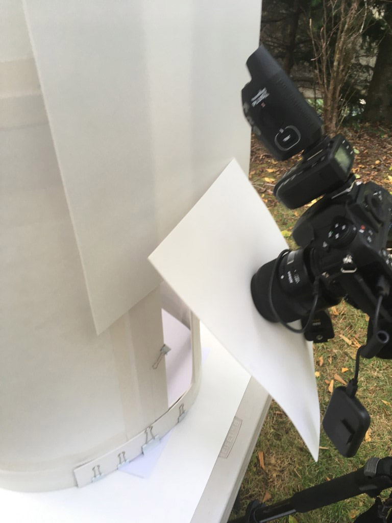

The "barrel" is three sheets of heavy-weight white posterboard, with slats from a discarded commercial Venetian blind used to reinforce the top, bottom, and edges of the opening, and [literally] half a roll of white gaff tape. The blind slats allow me to adjust the opening width to suit the item being photographed and the area above and below the lens is blocked with white craft foam.
Here's the full set-up:
The "barrel" sits on another piece of white card, and the key light is from above with a diffusion panel over top of the "barrel".
I also have a piece of white craft foam with a whole cut out of it to slip over my lens, and 'though it's not visible here, I also have the front of the lens lined with white gaff tape.

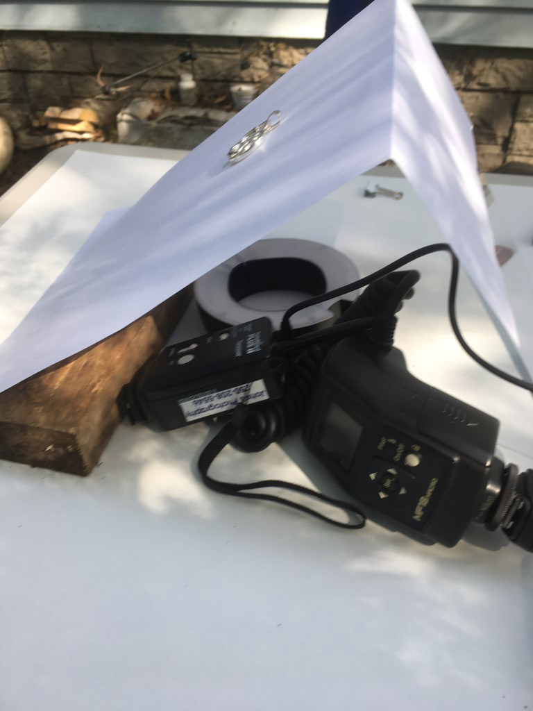

The item sits on a piece of clear plexiglass covered with a sheet of white paper.
A light from below provides the "white" for e-commerce 'sites; in this case a macro ring flash which provides a more even, wider spread at a such a short distance. The objects are held im place by double-sided tape, Stickum, clear adhesive and whatever else works.

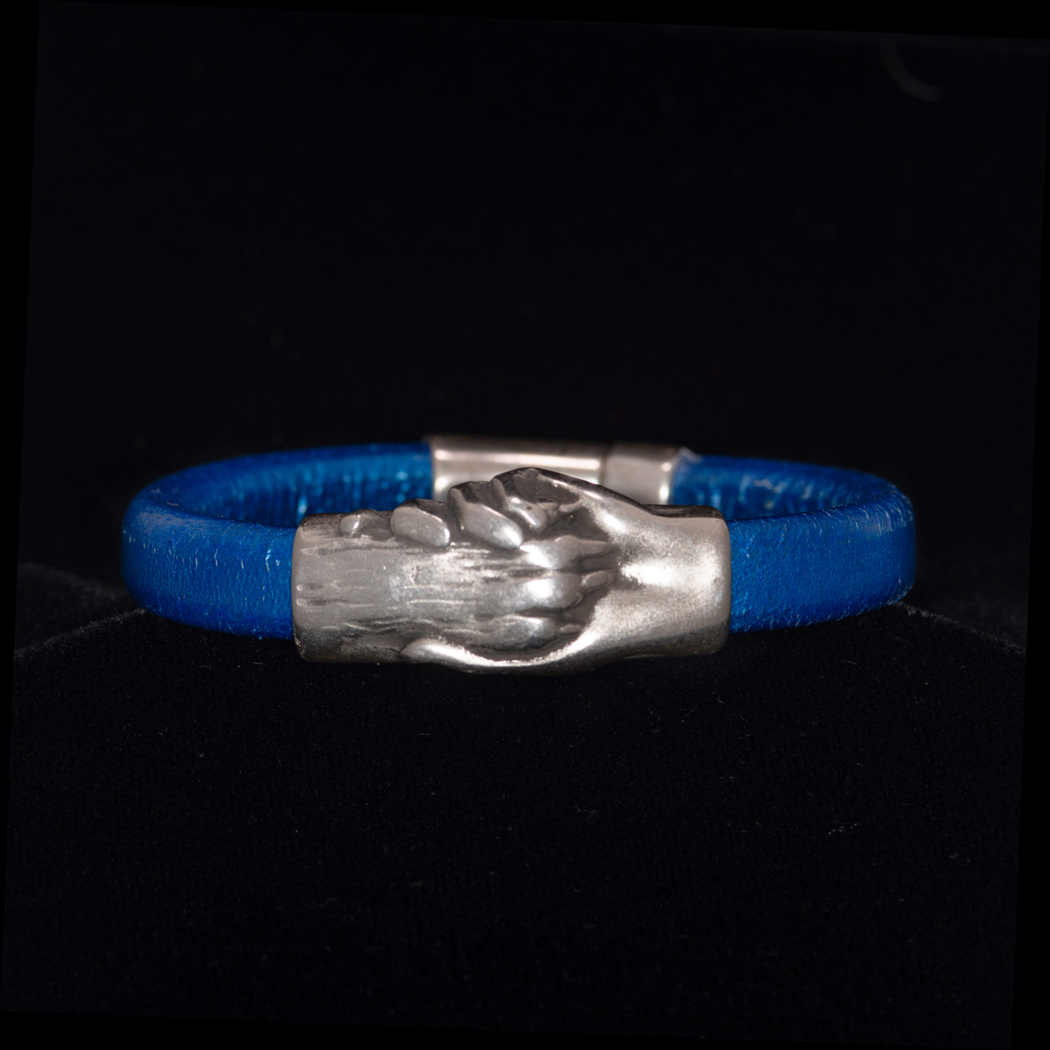

I wish! I've actually got white plexi which works even better, but the client doesn't want that. One of the e-commerce 'sites on which she sells apparently rejects anything with a shadow. If it doesn't look like it's floating, then it doesn't get in.... Honestly? I think the whole white background thing is crap, but if she's will to pay for shadow-less white, shadow-less white she shall get.

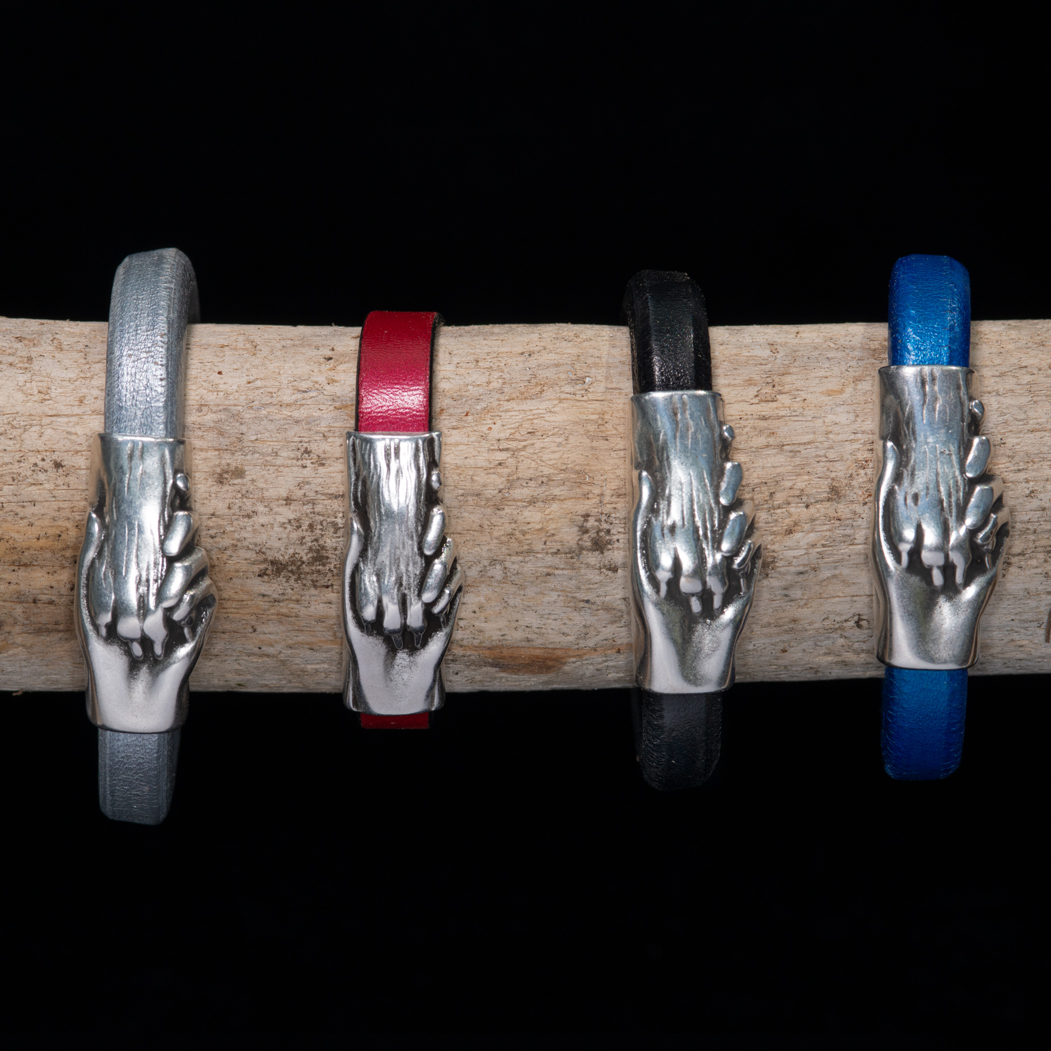

The editorial stuff for use around the booth in trade shows and in print looks MUCH better IMO ('though these are only concepts at this point, hence the different sized bracelets, etc).
