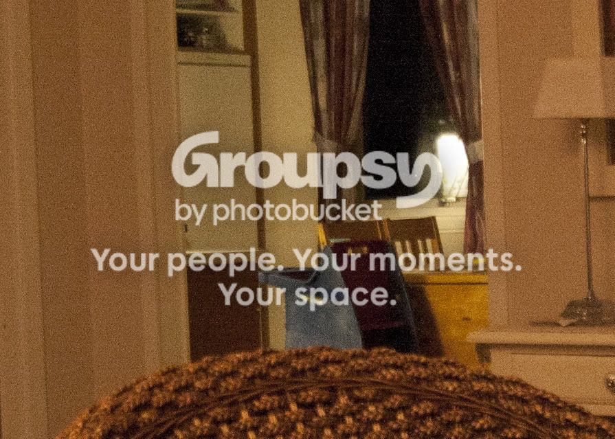

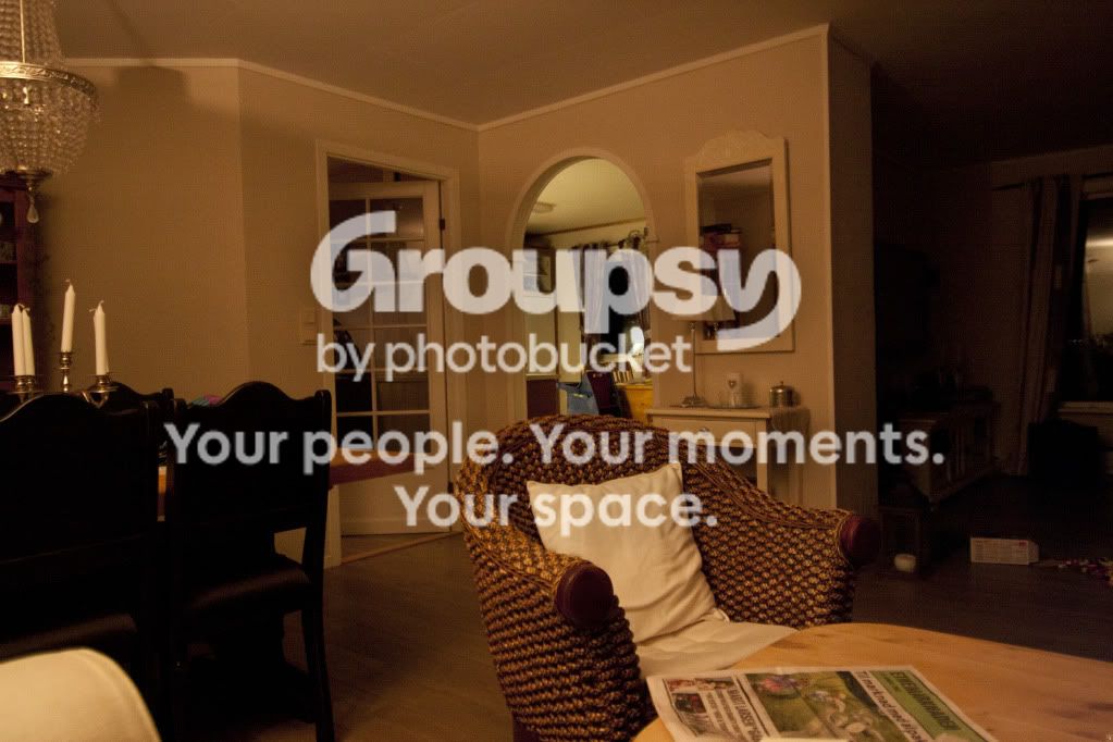

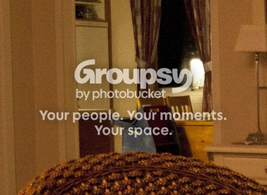

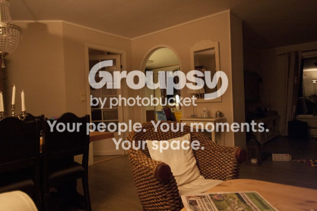

Quick test. Notice the noise, as well as shadow detail.
Canon EOS 40D, Tokina 11-16mm @ f/2.8
0EV @ ISO-3200 (ISO-high setting)
100% crops
-1EV @ ISO-1600
100% crops
