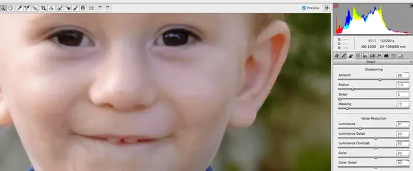

In reviewing my past usage with this lens, I have taken a lot of good photos with it, but only in bright sunlight for the most part. I have done some external flash indoors for family events in the winter, but generally I don't even attempt anything indoors or shade anymore. I have attached 100% views (embarrassed though I am) to demonstrate the level of bad that brought me to this forum ;)

If you’re far away a shallow depth of field is not usually an issue. You can look at a dof calculator or app to see. I’m not familiar with that lens but if it’s a continuous f4 regardless of zoom then I wouldn’t be shooting at f7 unless I could do so with a manually set low ISO.
Looking at your example photos, did you shoot in raw and have you applied sharpening and noise reduction? Also shooting at the extreme end of a zoom is typically never it’s sharpest….
