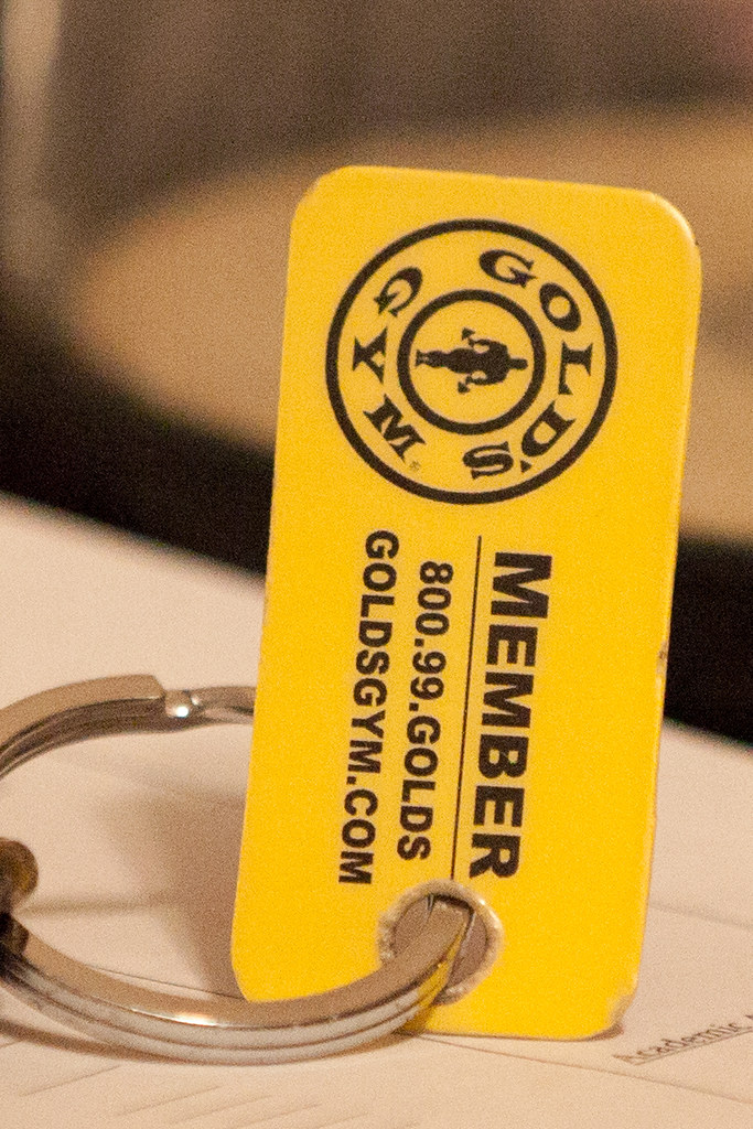

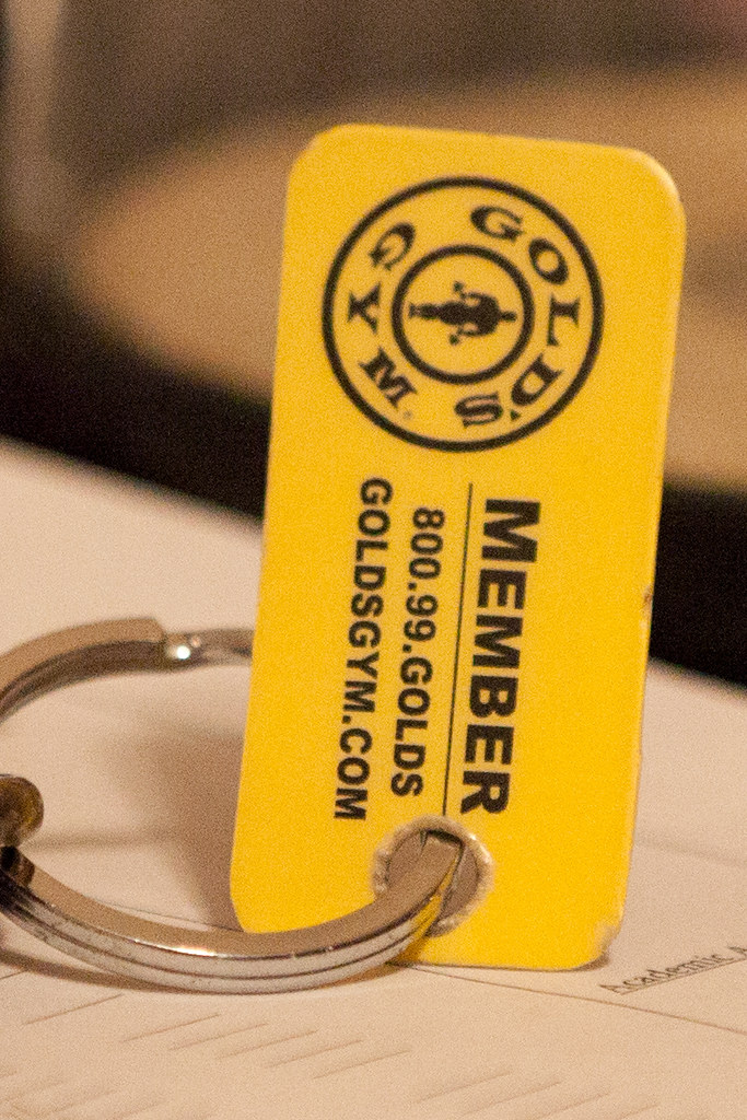

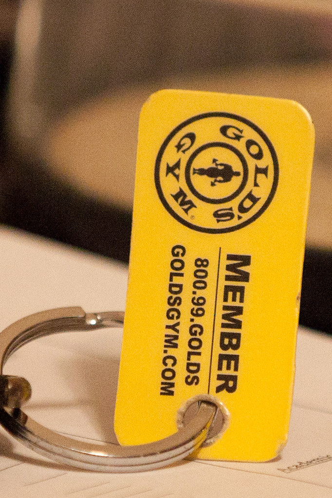

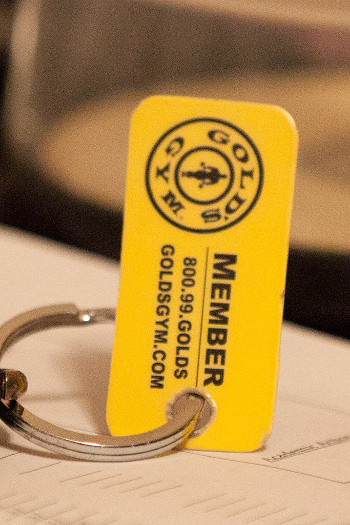

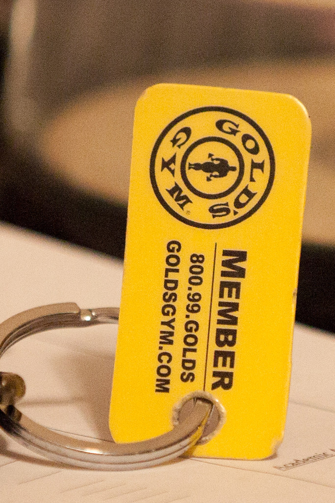

Micro adjusting my lens. Tell me which one looks the sharpest. Ignore the noise as they were shot at ISO 6400
4
5
2nd one is looking the sharpest to me.
I would also say #2. Why are you doing sharpness testing at ISO 6400?
it was night and I did it indoor w/out flash. I will have to re do it again today when it's light outside. perhaps of that same tulip
#2 appears sharpest, where exactly were you focused on though?
I'm pretty sure this is not a good test to follow lol. Print yourself out a focus chart and work off of that and not in a dark room at 6400 iso.
ISO 12233 Test Chart
Yeah that's what I gotta do. Although more and more people are doing it w/out the chart but using outdooe subjects from the POTN forum. I will have to do it at ISO 100 or even 50 on a day time and see result. But even at this the +5 MA looks a bit sharper than 0
The problem with choosing a regular subject is that I can't tell which of the above is the sharper because I don't know what part you are specifically focusing upon. 2 looks to be the sharpest overall of the subject, but slight lean in the subject or you focusing on something other than the big circly bit at the top means that I might be making a wrong assumption as to the focus.
Many people like to do tests because "they know they should do them" but they also find test charts boring to shoot - so they pick something more interesting. A flower outside is highly susceptible to wind motion and not an ideal test for fine tuning focus accuracy. Indoors - good light and flash - with a test chart (dull as anything) at the 45degree angle to the camera body. Boring - dull - tedious and not the kind of shots you'll be doing anything with save testing - but it works. It's methodical - it removes the most chances for user and environmental error and its repeatable to check after. Note make sure you have good lighting - slight miss focusing when testing in dim conditions isn't going to show a natural camera inaccuracy with the focus calibration, but might just be showing you that you pushed it a bit too far in dull conditions.
Good advice overread! Thank you. I didn't think of all that but you're right. I will print out a chart and do that also and re post.
