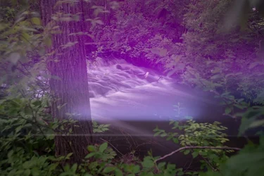

Because I had such great experience with the Tiffen polarizer, I decided to go the Tiffen route when I wanted a strong ND. That was a mistake. Every shot is pretty much completely magenta. It's impossible to restore color by changing the RAW file's WB, so much color is lost for good. This ND 3.0 was around $35-40, if I remember correctly...

The Magenta is probably from light leaking in through your eye piece,
You need to cover the eye piece. In higher end cameras they have eye piece shutters, which closes the eye piece to prevent light leakage on longer exposures which the sensor ends up seeing and casting a weird magenta shade over the image.

It's definitely not from the viewfinder, because it's an EVF.
I shot a white wall to see if it's even, and it certainly was. Strong, cheap NDs aren't really neutral.
