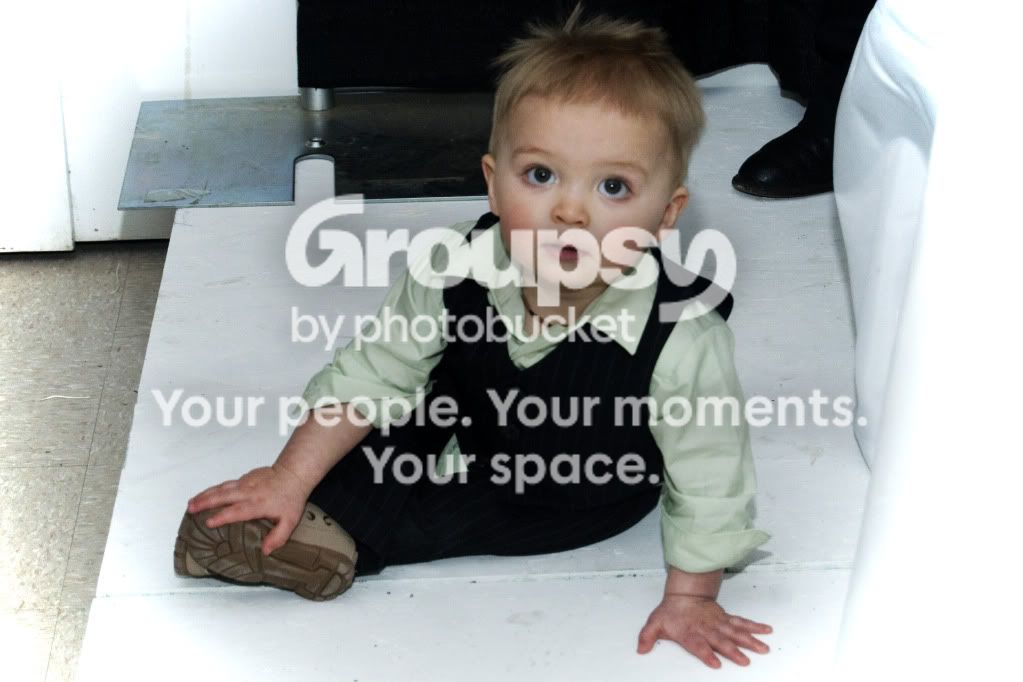

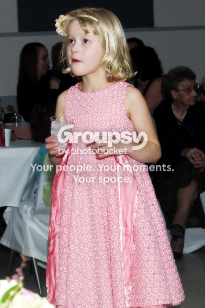

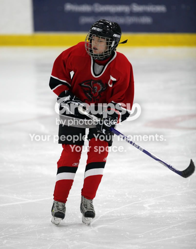

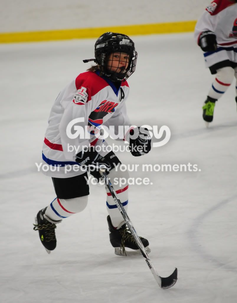

Thanks! Here's a few examples of what I mean. The first is a hockey tournament I did. The player in the red was taken with my affiliates camera with the settings 1/500, 2.8F, ISO 800, and the player in the white is taken with the identical settings with my camera. I actually shot at a higher quality than he did (he shot in normal, I shot in fine), but his camers has 18 Megapixels, while mine is only 12. Not sure if you can see the difference, but when you blow the images up, it becomes very obvious to me. Also is a picture of a boy I took at ISO 1000 with my Nikon lens, and the girl was taken at ISO 200 (same location, she was just in the spotlight). Again, a MASSIVE quality difference. The first to me signifies the megapixels, while the second set the ISO. Again, any input is appreciated.

I am sorry, but I think that neither a better camera nor the lens will help you. My Rebel XS with my cheap lens is capable of producing much sharper images than the ones you posted. And the D300 you have is a much better camera.
Are these photos cropped? I think your hockey photo has problems with focus/motion blur. The one with the kid - again, it's pretty clear that your lens was focused on the background, leaving the kid blurred. And as for the girl, it's also not what the camera can do. I assume this one was shot with the 18-55mm lens. No idea which one, as there are a couple versions, but still, I think any of them could be sharper than that. Have you really focused on the face of the girl?
