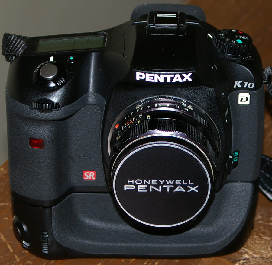

Here is my K10D with a Super Takumar 55mm f1.8 attached, I LOVE using the Taks on my digital. Don't let anyone fool you, these Taks are DAMN good lenses. And they are built like tanks !! make sure you buy the Genuine Pentax M42 to K mount adapter, it is by far the best one out there, and very easy to install and remove.
