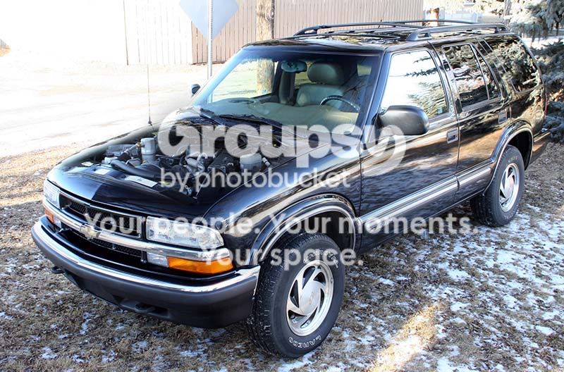

There is another technique, where you take two (or more) photos, uncovering something between exposures, then combine them to make it look like you are seeing through something...but in this case, the exposures don't have to be different.

Yeah, looks fairly simple. Just a plain old multiple exposure.

Big Mike,
those are very cool shots, never even thought of something like that. will have to try it soon.
