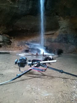

The center column turned out to be a big deal for me, too. Again, I tried an Induro with one of those reversible center columns, and I hated it -- what a monumental pain in the butt. My Manfrotto, on the other hand, has a center column that I can flip to horizontal in about five seconds. I fell in love with this in no time flat, because I'm constantly doing stuff like this:

Look at the leg support and see if the legs have middle supports, versus no middle support. Basically can the legs (like in Lambertpix's) completely extend away from the center for low photos
@Lambertpix .. looks like one of your legs is bent in the photo ??
Nope. It's carbon-fiber -- no bending. You're seeing refraction, I believe -- the left leg is half underwater.
