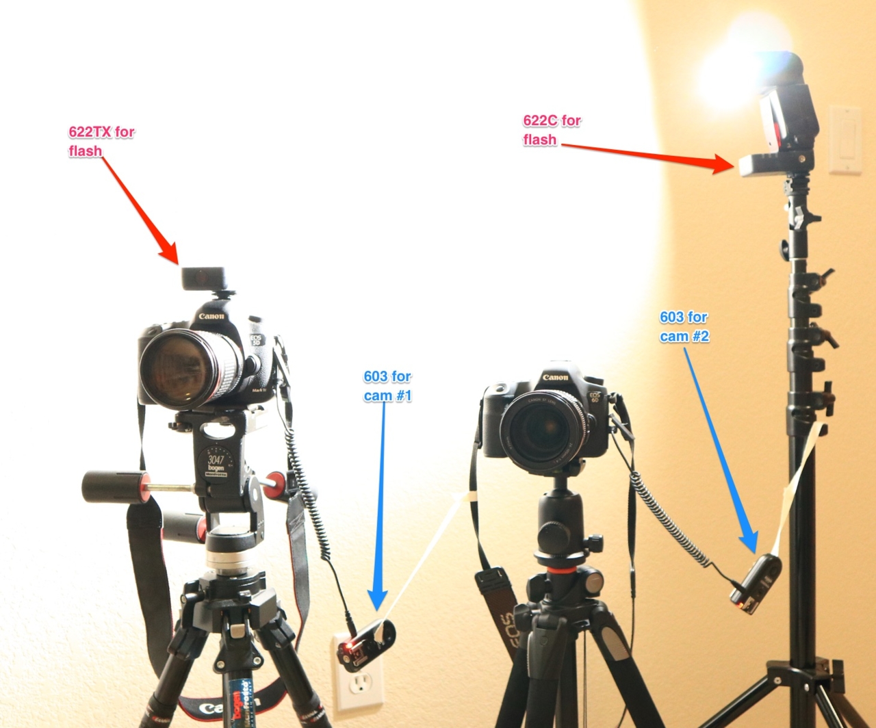

Here's picture of the setup. The 603 triggers are pulled away from hanging straight down with a strip of tape, just to make them visible for this picture. What you can't see is a third 603 on camera #3 which is capturing this frame. It's a fourth 603 in my hand that's triggering the whole set.
This is on Canon stuff, but the Yongnuo is supposed to work the same across Canon or Nikon.

On the 622's you have to use the test button. With the 603's you *can* use the normal shutter release button. With the camera you can't see from my picture above, I actually had to take a few pictures before getting the flash going off in the frame. In the process of taking those pictures, I was (accidentally) going back and forth between the shutter button on the camera and the remote.
