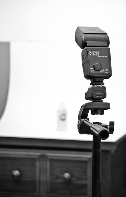

And super easy to hack. I've moved the slave sensor to the front (where it should be), added a 1/8 jack for triggers, and added external battery packs to a few of mine.
Oh, and I'm working on adding remote control to one so I can adjust power from behind the camera.
most of it except the remote is pretty simple. for the jack just splice the jack into the 2 wires coming from the hot shoe (if its a manual flash). For the batter pack, just get a female 3 prong power plug. You can google the wiring diagrams for it. on normal operation in runs off internal batteries, when you plug in the battery pack it bypasses the internal batteries and runs off the pack. For the pack pick up a D holder from radio shack and some D batteries. Mount them in a cheap pencil case and your done.

I want to do something like this--could you post some pics of what yours looks like with your modification?
Yes PLEASE lol
