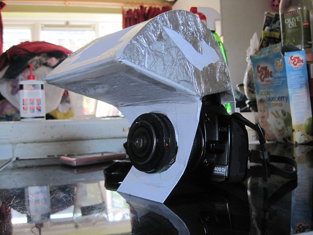

These are taken on my Canon 400d, 18-55mm kit lens installed correctly with +1, +2, +4, +10 dioptre filters added, and light provided by my super duper light diffuser/deflector that I made from mount board and tin foil. What do you think?
Here is the Super Duper Light Diffuser/Deflector...
For me, these are way overexposed with harsh lighting (i.e. hot spots) which is surprising considering the large size of your diffuser's opening. I'd try backing the flash down a good bit and go from there. Lighting looks a tad flat to me as well, but that's probably a design of the diffuser from coming from directly overhead instead of slightly off axis.

I have backed down the flash for some photos, but maybe not these...I can see what you mean about the hot spots.
This is only a first approximation for a diffuser - off-centre mounting might be the next step, but the engineering with the mount board will be a lot more difficult! :mrgreen:

I use cardboard which is nice and stiff. I also completely coat the outside with strips of Black duct tape which makes it sturdier overall and looks less obtrusive. Might give it a try. My diffusers are pretty flimsy at first too, but once covered with the duct tape they are very sturdy.

Nice DIY nonetheless. Must be a bear to handle though.

Can't do spiders with it...the diffuser wrecks the webs :(
