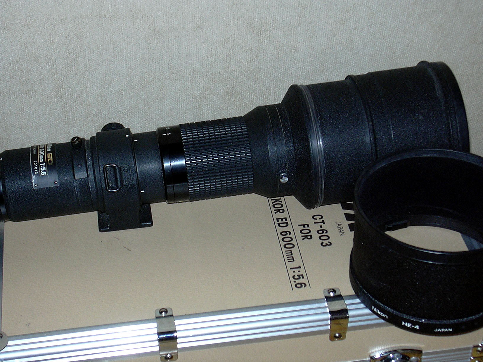

I use a nikkor 600mm f5.6 ais ed manual focus lens at the zoo. It's amazing. They cost around $1500 used, but are worth it. It would work perfectly on your D300s.
If that's too pricey, consider a 300mm f4.5 ais IF ed manual focus lens, it's extremely sharp wide open, and very light weight and silky smooth to focus. They sell for $275-$400 on ebay. I used one for years, and only recently sold it because I upgraded to a 300mm f2.8 af-s--a $3000 lens that isn't really any sharper at f4.5 then the other one was.
If manual focus isn't your bag, the 300mm f4 af ed can be had for $400-500.
