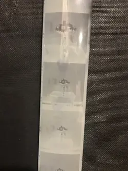

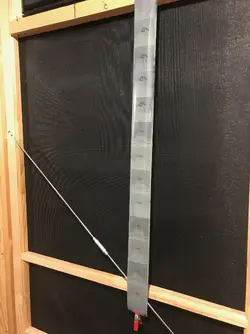

Would someone be kind enough to tell me what I did wrong here? It is JCH Street Pan 400. My first time to use this film. I'm guessing this is not the color it should be. Further guessing this will turn out to be a rookie mistake. Thank you in advance for any help you can offer me.

Looks fine to me. I see evidence of a light leak, but nothing unusual about the color.

All other developed film comes out blackish.....this is pale yellowish. Never seen this color. Is this an attribute of JCH film? And thank you for your response.
Hard to say, but it looks like its not fully fixed.
That was my first thought, before opening the thread and seeing the photos. The purple-ish blotches are cause for some concern...

If it is the color that concerns you, it may be the normal look of this film. According to reviews of the film it is supposed to have a gelatin coating on the back side which is unusual. That could account for the color and some B&W films do have different colors when processed.
I was going to say that it looks similar to what my old Agfapan negs looked like ... then I found an article online that mentions that your film was possibly born from Agfa surveillance film ... hmm.
