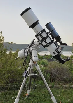

Although the catadioptric scopes are nice their long focal length means that extra careful attention must be paid to your mount's tracking abilities and the stability of its support. I use an 80 mm f5 refractor, a 152 mm f6.5 refractor, a 150 mm f10 SCT and a 180 mm f15 MCT. Different tools for different jobs.
Below is one of my scopes cooling prior to an evening of splitting close doubles.
