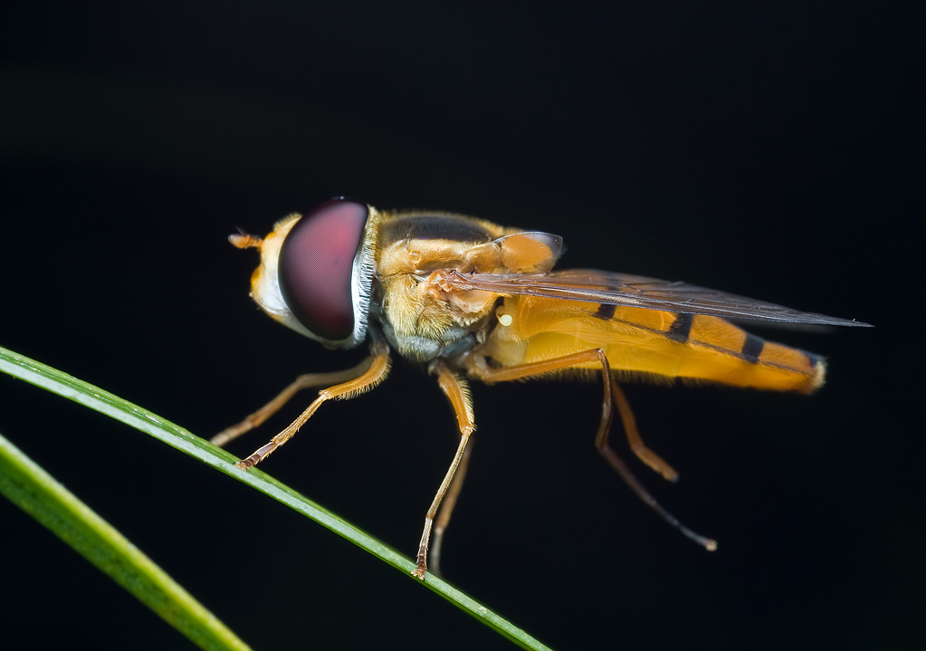

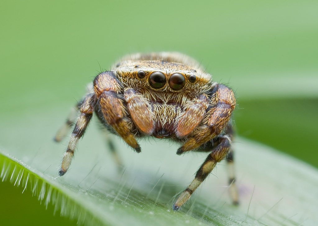

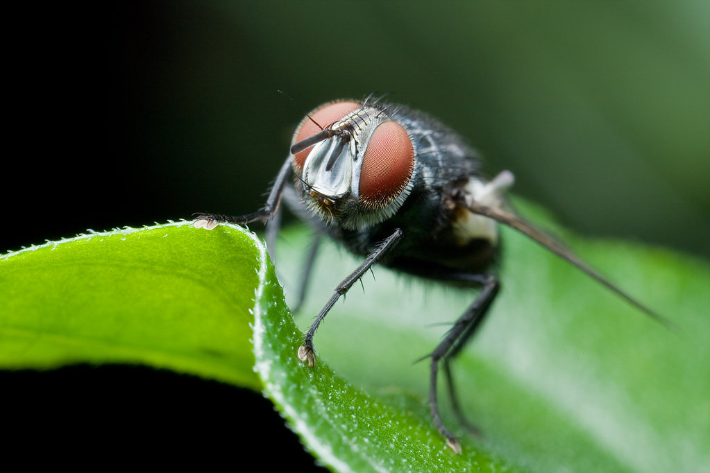

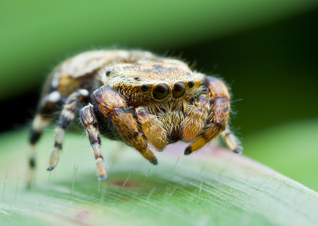

A few test shots of a single 270EX on Front Mounted Macro Bracket (FMMB), and MPE65, full flash. All Exifs are intact.
Heavy shadow on the lower part of the subject. I think it's because the light comes down from a higher angle.

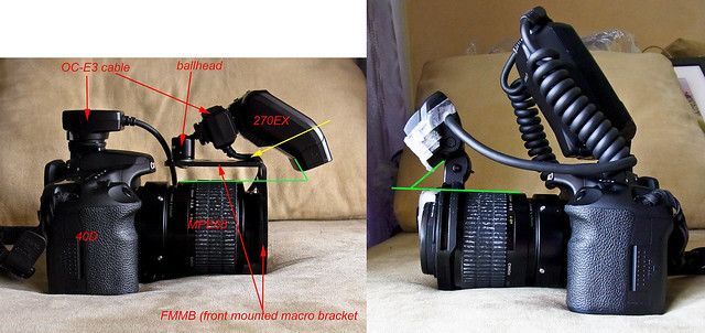

Very dim catch lights in the eyes. Again, caused by the same high light angle i think. Refer to the setup pic.
Setup pic:
Like the results and can see the how the angle is affecting the light. Though I wonder if you were to mount the MT-24 heads on say some Kaiser hotshoe, would you not be able to achieve the same high angle. I have one flash head mounted on one of these, and use it as a sort of flood light. Then other I light from the side. Looking to try out the light tent option following your earlier results.
I have to ask what of the two flash setups you now use. Do you now use this 270ex version - or the MT-24ex ?
