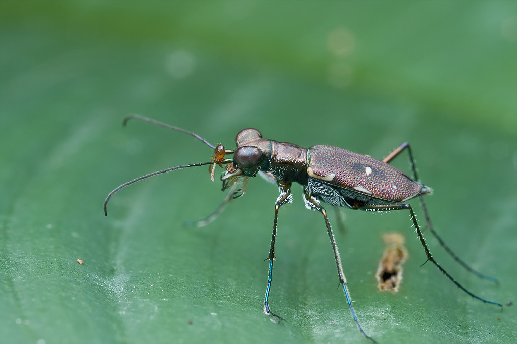

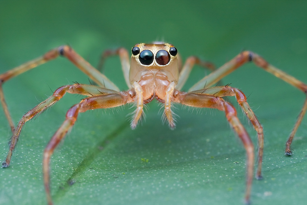

Insects Macro Photography: Single flash and twin flash shoot setup
Here my blog with a 270 EX, and twin flash setup i hope it help the jumping spider shot with 270EX
