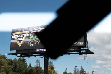

Hey guys, new to the forum. Hope this is the appropriate place to post. I've had my 70D for for 2-3 years now and it's worked flawlessly. Out of the blue yesterday, this started happening. I changed lenses and got the same result. I know I need to call Canon, but don't have the time right now and thought this might be a good place to get a quick answer. Am I doomed?
Weird. First I thought it was maybe the shutter sticking, but that tends to give you a straight line (could be at the bottom of the image) but the top part has a distinct curve. Hmm... I'm still going with some kind of shutter mechanism issue as mechanically it's the only thing I can think of that would cause this kind of issue. Maybe someone else make a better diagnosis.
Thanks for the reply. So you're not thinking a sensor issue?

Looks like it is service time to me. Give Canon a call, tell them the problem, they may have you e-mail them a photo. You send it in for a free estimate and then decide if it is worth the amount to get it fixed or not.

I'm thinking it's a possible light leak from the left side of the image. Given the problem occurs on multiple lenses, it's not a damaged lens like the 16-35 I split open when I dropped my camera several months ago. But if you recently dropped your camera, it could be a damaged mounting ring.
Another possibility is that the camera firmware is damaged slightly, perhaps due to overheating, the EPROM firmware that does conversion to JPG has a problem. It could be a similar problem in your post processing software and/or hardware. To narrow it down, check the image on the camera LCD. If you can 'zoom in' on the LCD, see if the problem is there. If so, it's a camera problem. If so, then download the RAW file to your computer and view it there with your PP software. If the problem is NOT in the image, then it's the firmware in the camera. If the JPG is OK on the camera LCD but screwy on your computer (as JPG), you may have a RAM or HD problem on your computer.

Great help, thanks for your reply. I can definitely see the problem when viewing the image on the LCD, so the problem is in the camera. I will try your RAW suggestion. A light leak seems like a good guess, but I haven't dropped my camera so I'm not sure how the mounting ring could've been damaged.

That's the shape of a jammed shutter blade. You've got a sticking or jammed shutter blade.

Just updating you guys... indeed, it was the shutter curtains. They replaced the shutter assembly. $285 + $25 for the initial shipping w/ insurance. Kinda stings, but hopefully I'll get several more good years out of her.
Curious, do you guys think this happens with use or perhaps sand or something got in there and jammed it up?
