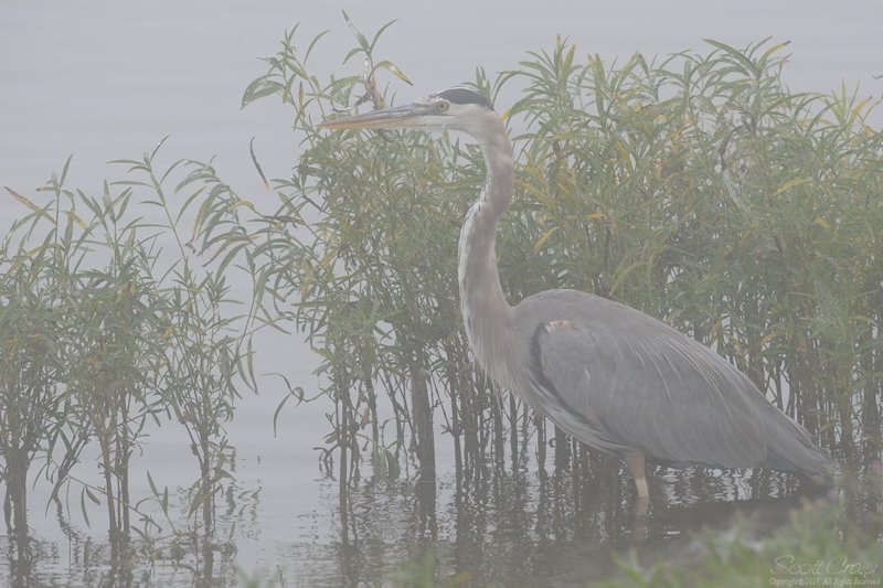

I went to Old Hickory Wildlife Management Area this morning, one of my favorite bird haunts, and it was foggy. When I say foggy, I mean F-O-G-G-Y! I can deal with fog up to a point, it's not that hard to get rid of, so I thought I'd post these to show the difference that can be accomplished with some judicious post-processing.
Here's the original. Shot with my D7000 and Sigma 150-500 lens. 15 meters focus distance (which gives an idea of the level of fog!), 270mm, f/5.6 at ISO 200 and 1/160 second. In my opinion the fog ruined it so I wanted it gone.

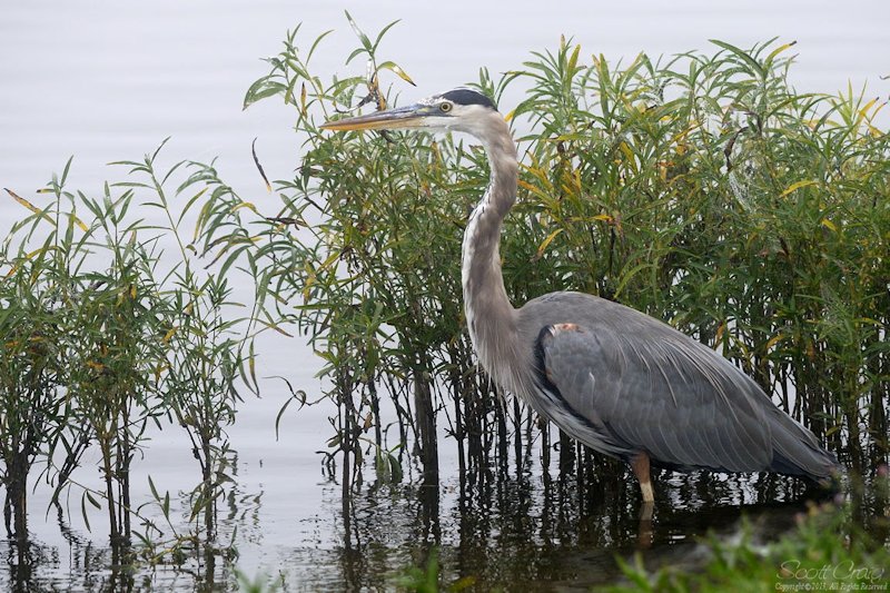

With a bit of editing in Capture NX2 I pulled this out. Nope, it's not "All Natural" but in my opinion it's a much better photograph.
Still not quite the dynamic range I wanted so I created 3 separate TIF files from my NEF file, 1 at -1EV, 1 at 0EV, and one at +1EV, and tonemapped them with Photomatix. No over-the-top cartoonish colors or halos or anything goofy, just a bit more detail in the water and shadow which is what I wanted.
The abilities we have these days frequently amazes me. I've spent a lot of time in a darkroom in the past and perhaps there is a way to remove that fog in a darkroom, but I wouldn't know where to start. It took me less than a minute with Capture NX2. We can do things today that were only dreamed of 20 years ago, and making use of those tools is very valuable to me. No, it isn't an "All-Natural" photograph however the all-natural photograph that I shot wasn't what I wanted either. I took a bunch of photographs this morning, all in fog like that, and never gave it a second thought because I knew I could eliminate it in post processing.

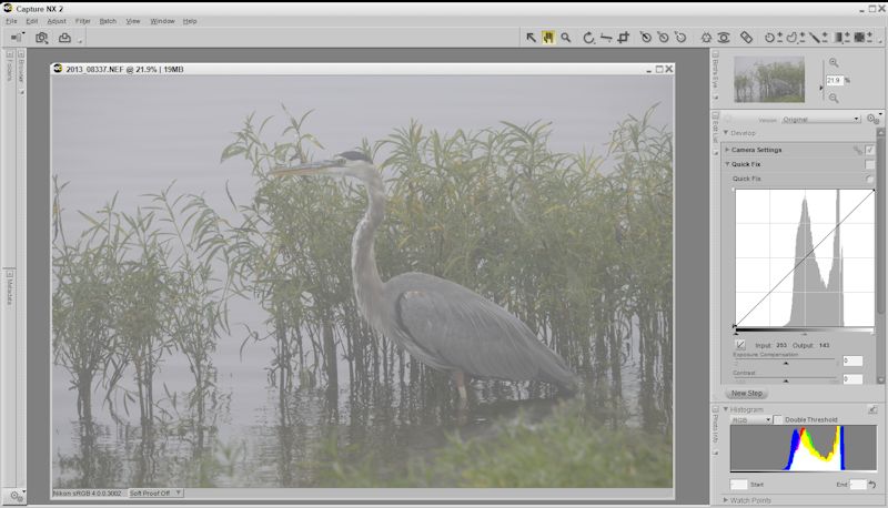

Original photograph in Capture NX2:

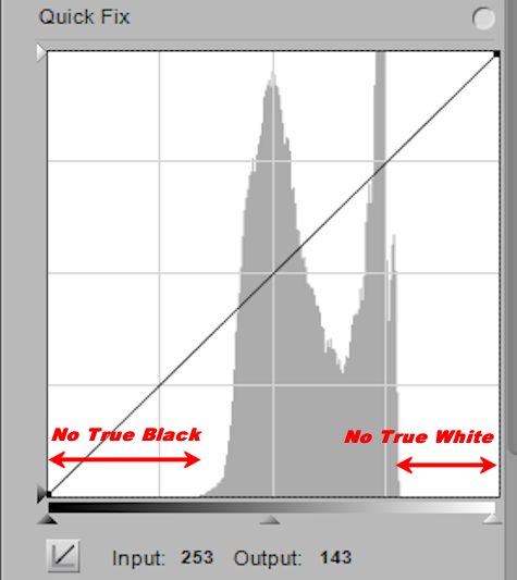

Take note of the histogram at the bottom right of the screen and the histogram editor above it. Here's an enlargement of the editor:
Notice how the data is all located in the center of the window and does not extend to the left (black) or right (white) edges. That indicates that there is no true black or white in the photograph, and that is ALL that needs to be fixed to eliminate the fog.

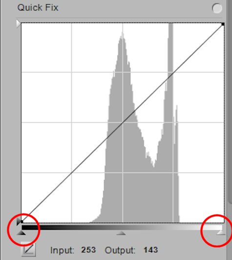

There are a couple of ways to do it. This is the method I commonly use simply because it's the easiest. Below the histogram editor are two little triangular buttons as shown below:

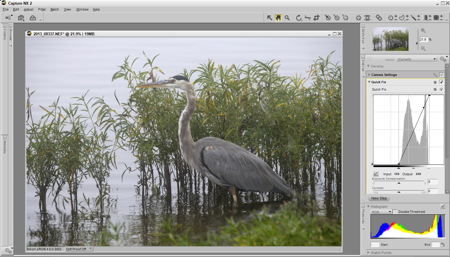

Slide the button on the left to the right so that it is at the edge of the data (that's step 1). Slide the button on the right to the left so that it is at the edge of the data (that's step 2):
That's it. Take note that the histogram at the bottom of the screen now extends from the left edge (I actually went slightly too far and there is some clipping) to the right edge (well, almost. I should have gone a bit farther). Total time to virtually eliminate the heavy fog visible in the original image: About 10 seconds.
