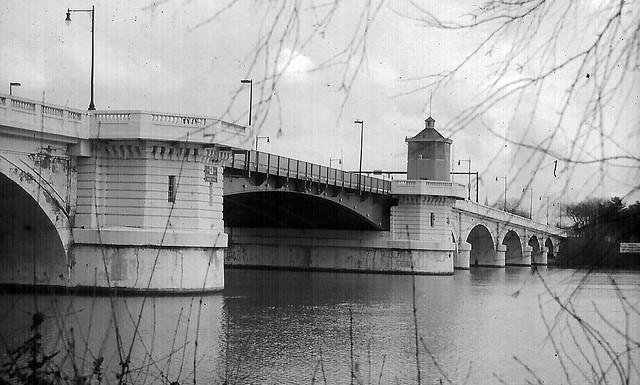

cherry street bridge.
i was trying to frame this in with some of the trees on this side of the river. but not sure how that worked out. obviously my subject was the bridge, and i tried to follow the rule of thirds by putting the pylons on the top and verticle lines.
2. for this shot my film was still iso 100. i changed my shutter speed to 125 so it would be faster than the film instead of slow. the sky seemed darker to me, so, going off the chart i had, i dropped to f8. again, don't know if that was the right choice. but that's why i did it.
Image1.tif by jaythomson, on Flickr

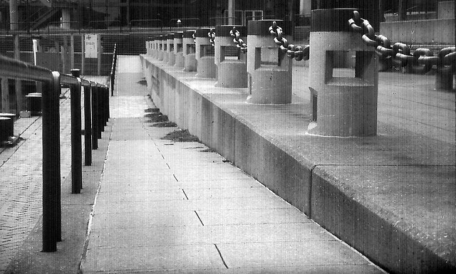

riverfront chains and sidewalk
i don't want to overwhelm the thread with too many images. but here is one more i was happy with. both the composition and the result.
4. iso 100. shutter speed 125. f8
Image2.tif by jaythomson, on Flickr

but, after further looking at the "streaks" they can't be from my fingers.
on my landscape fotos, the streaks are vertical. and perfectly spaced and symmetrical. if they had been from my fingers, they would have been horizontal to the image. and couldn't possibly have been perfectly laid out like they are.
leads me to believe they are in the film. perhaps an error in the way we processed? i'll have to ask more about it in the darkroom. i've noticed that ALL the images from all three rolls have it. so it's definitely the film, not my fingers.

Hmm, I see the streaks in the images, I don't believe they are from your fingers. Can you see them on the negs (they would be black on the neg)?
They could be from the scanner and not actually from your processing.

The lines do not look like it is occurring on the negative ... these would be very evident if you look at the neg's (with a diffused light in the background) with a magnifying glass.
The lines are too uniform and there are jagged edges that can be seen.
The only other time that I have seen banding is if the film is rolled backwards ... this was common on older cameras with manual film winding ... but they normally are thicker and not uniform.
i do NOT see them on the film !!!! yaaaaaaaaaaaaaaaay
i'm looking at the banding and i think i know...
it's the scanner.
