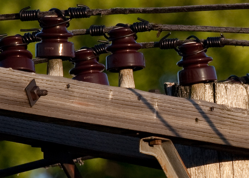

I just got the 100-400mm 4.5-5.6 IS L
It'll make you want to runover your zoom with a truck. (take pictures if you do)
ISO100
f/5.6
1/250
@400mm
100% crop SOOC
Granted, this wasn't 2 miles away. I can't wait to see what the lens does over distance.
Damn. I see why people shell out for the white Canon lenses..
EDIT: It's important to note that Bitter's shot is from a full frame sensor. But a good sensor doesn't make bad lenses better, so it still makes a valid point.
