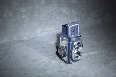

My old reliable showing a few "normal wear" marks.
