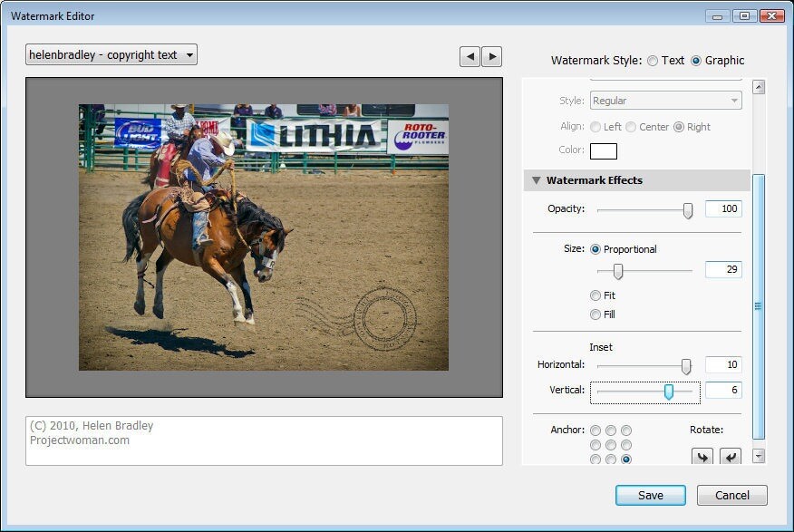

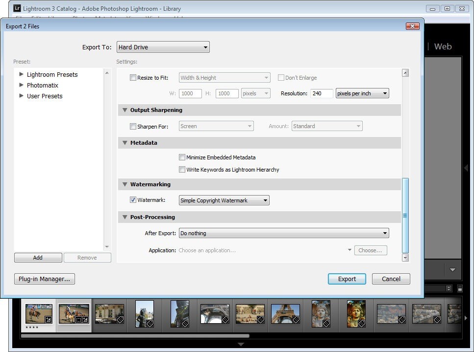

OK I have Photoshop Elements 9 and Photoshop CS5. I have a custom watermark that a graphic designer made for me. I want to apply it to all of my photos at once and have them all in the same spot and the size proportioned depending on the size of the pic after I have cropped them. If neither of these programs are good, what can I use?

I know lightroom has this feature, to be able to place water mark on your images in a certain spot your specify. might wanna look into that
Lightroom 3 buddy. Custom watermarks on as many images at a time as you please.

Actually it does, it be pretty lame if it didn't allow that. Just pop it open in PS, make the size you desire, save it as a .png and import it in Lightroom and your golden.
My watermark is .psd. I don't want to create a watermark in Lightroom. I dont think lightroom lets you put my custom watermark on all the images.
Worked like a charm! Thanx!
