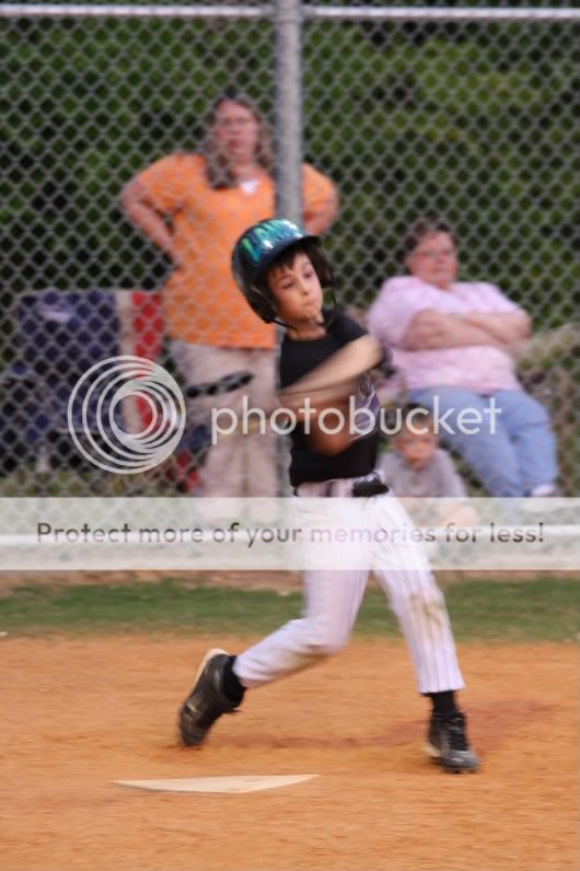

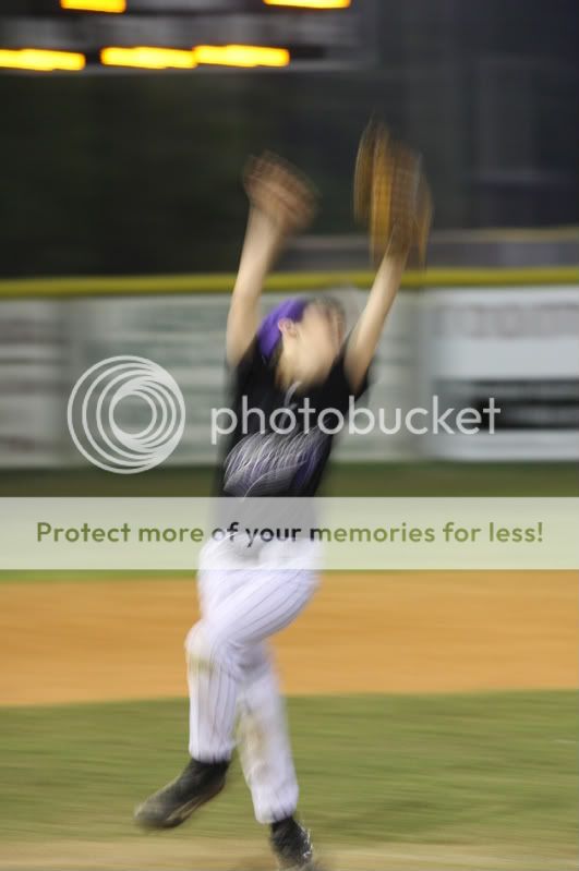

Advice needed for sports shots
And another.
Settings:
ISO 800
F/5
1/30
One problem I have with my Canon 70-300 lens is I always wondered why they came out blurry after basically holding the camera very still, high shutter speeds (500 -640 minimum)...
I learned that lower quality lenses arent very crisp and sharp when they are "fully open" (low F number, such as 4.0 of 5.6)
TO get crisp pictures it should be around F9 to F11. But since you seem to have low light conditions...
I am a notice from experience with the same lens...
Edit: Mine is the Non IS lol
Well there you go. Your shutter speed was 1/13...where it should have been 1/250 or 1/500. It's not just your son that is blurry...so there is also blur from camera shake going on here. IS will help with that, but it's not a miracle cure.
Looking at your settings...the light levels were low. Even if you had bumped the ISO up to 1600, your shutter speed would only have been 1/25 or 1/30...which still isn't nearly fast enough.
You need to be 4 or 5 'full stops' faster....and you just aren't going to be able to do that, with that equipment and especially in that poor light.
Try again when it's actually a nice bright day and see if you don't get better results.
Those were the Auto settings the camera set while in Sports mode.
Firstly, there really isn't anything that the 'picture modes' do that the other modes can't do. They just let the camera do the thinking (which probably isn't a good idea, since it doesn't have a brain ;)).
It would be much better for you to learn about exposure (shutter speed & aperture) and then you can consciously think about what the camera is doing.
That being said, the settings that the camera set in sports mode...are probably what I would have set...the aperture was probably at it's max and the ISO was fairly high. The slow shutter speed was just a result of the low light levels. If you had manually set a faster shutter speed...the photos would have been underexposed...probably quite a bit by the time it was fast enough to freeze the action.
To say it another way...there was nothing that you could have done to get sharp shots in this situation...except bump up the ISO a bit more...but that probably wouldn't have been enough.
I guess you could have used a big flash...but they probably don't want you firing a flash at the players ;)
Your options for the future are to get a 'faster' lens (larger aperture) or shoot when the light is better.
Hey there,
I have a fairly new camera so I am still learning all the bells and whistles, so please bear with me..
However, I have been taking some pictures at my son's baseball games.
The still shots of him on the field look great. I am having trouble with action shots. When he is swinging the bat, the bat comes out very blurry.
Also, I took some of him jumping up to catch a ball and he is blurred.
I had the camera on Sports mode which is what the manual said to use for action shots. Any suggestions? he has a big game tonight and I would like to get this figured out. :-)
My camera is a Canon EOS 40D and I am using a Canon 70-300 lens.
Thanks for the help.
First of all, get it out of the PIC modes. You've got a good camera there and you won't get very far if it's always on automatic. Read the tutorials in my signature, they'll give you a good foundation in basic photographic technique.
For sports, I'd recommend that you set the camera to Tv mode (Shutter priority) and set the shutter speed to about 1/500. This should be fast enough to freeze most movement, giving you nice sharp photos.
However, the lens you are using is rather slow (only f5.6 when it's zoomed all the way in), so you'll probably have to increase the ISO in order to get properly exposed images. Don't be too reluctant, as the 40D's performance at higher ISO ratings is very god, and you won't get much noise in the pictures. in Tv mode, you can bump the ISO up to 3200, which is two stops more than 800.

You're trying to take photos of fast-moving athletes. You'll need to get the shutter speed up around 1/250 or faster to really freeze the action.
When you're in a low-light situation, I'd suggest making certain that ISO extension is turned on (so that you can select 3200), going to Av mode, setting ISO to 3200 and aperture to maximum (f/5.6 at maximum zoom or f/4 at the widest), and hoping that there is enough light that the camera's metering comes up with a decently-fast shutter speed.
There is some increase in graininess at ISO 1600 and 3200 compared to 800 or less, but this would be better than the subject blurring that you're getting at the very long exposures.
Since a big flash would probably distract the players, your next step would be to get a larger lens that could gather more light.
