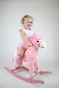

I am fairly new to photography and would like some feedback on these photos. I have only done shoots with my own family and friends so far. These photo are of my daughter I done recently with my wife. I am looking in to start making this into a small business and have my first booking coming up. I would like as much feedback as possible to help me improve my photos.These are just a few from many many others. If you could also tell me how you would enhance these with editing that would be great. I have gimp 2.8 for editing.
Pretty good so far.
I don't know what light you're using, but it appears to be one bounced flash. Not too bad, but the subject's face needs a wee bit more light. In all three. Do you have only one light, or is there another light you can use?
I see some fall-off toward the corners, (or added vignetting) which is distracting, and should not be there.
In #3 you should have attempted to not include the child's diaper, as that also is distracting.
I really like #1 with just the one prop. #2 could lose the green toy prop, and in #3 the balloon makes more shadow just where you don't want it.

Go ahead and try the ceiling, but think about the fact that the light then comes from above your subject, so you will want to evaluate the shade and shadows.
You could also try a wall behind you if that wall is white. Or a wall to one side will work too. If they are white. If the walls are not white, you can either adjust the color in editing, or find some large white reflector. I have several large sheets of white foamcore.
Shot #1 is really cute in expression and props. THAT will be a great, lifetime shot of her as she grows. Shot #2 has too much top space, and would have more impact if the top were cropped down a bit, or better yet, crop it to a horizontal by cropping a little off the bottom and a lot off of the top. The third shot is a bit less-compelling than 1 or 2 due to the balloon and the visible diaper.
I think #1 shows some lens faults, and I would look into applying lens corrections in light room to get rid of that lens's distortion signature.
The light fall-off does not bother me all that much, but it could be corrected in Lightroom. I like a little bit of fall-off, but this is more than a little bit, and some people really are sensitive to light fall off on light backdrops.

Well...here's what I meant...in Lightroom, there is a thing called Lens Correction, and it is there that one can modify the images. In Lightroom, I opened the large size image and manually corrected the light fall-off, and corrected some chromatic aberration, which is a common fault that 18-55 kit zooms often display. It's a subtle thing, but it gives an effect similar to looking through thick aquarium glass...things are sharp-ish, but there's also a very,very slight "wonkiness". here it is, exaggerated quite a bit, so it is super-obvious.
This is the manual vignette removal and the manual chromatic aberration I removed from your large-size web image.
THIS is what really BAD red/green chromatic aberration looks like. This is sometimes called "color fringing", for obvious reasons, also called "CA".
As you can see, the vignette removal tool allowed me to brighten up and eliminate the light fall-off at the corners of the image.
Some cameras have a setting that allows the camera to automatically eliminate vignetting on JPEG files the camera makes; I am not sure if your camera has that option.
that makes more sense now and i can see what you mean. I am using the canon T3i. I think my camera does that and it is called Auto Lighting Optimizer. I have had this turned off up until recently as like i said i am still learning. Is light room a free software? I currently have gimp 2.8 because it is free.
