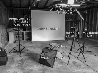

Testing out the new Einstein again, and I absolutely love this strobe. The quality of light is amazing, the ease of use and portability is perfect for my kind of shooting.
No more running wires everywhere, no more tripping over them. I'm even thinking of getting one, maybe two more.
I definitely want to get some modifiers.

Behind the Scenes
Camera Settings
Nikon D4
1/250
f16
iso50

happen to have another light to do a camera axis fill that's like half the power as the main? if not, that relfector needs to be moved in to fill in a bit better. you're really dark on your right side.
Yeah I have one more light, however I don't have another light stand haha.
I didn't want to much fill, as I thought it wouldn't be as 'dramatic'.
But, maybe its too much shadow.
^^^That. BUT...
Damn Sean!! Look at you looking all sexy!! I love the 4th one but you do need a little more fill.
Don't let Maria see this! She has a no shirt rule for male portraits...hehe
Time for another pair of light stands and a grip arm for the reflector! I like the quality and temp of the main light, and I think the rim light is about the right strength, but like everybody else, I am craving just a bit of a look at the shadow side of the face. I dunno...split lighting has never been a favorite of mine. One side dark, other side light. Yeah, in theory it always sounds good, but in its realized form it often disappoints (like so many ABC comedies).

Here's one with a little more light on my face. After this shot I turned off a light, to try and get more dramatic. I should of left it haha
Derrel, that sounds about right! I also need a nice boom arm, so I can get that main light right above the camera.
I agree, a boom arm is very handy. I started off my studio lighting career back in '87 with the Bogen Heavy Duty Boom and Rolling Stand, $259.99. That was a month's rent back then, plus $20. I still have it, and a second one I got years later. One of THE best investments I ever made in lighting. Nowadays, with the influx of low-priced lighting and grip gear from China, it;s possible to buy simple boom arms for a low price, cheaper than they have ever been. If you put a boom arm on a good C-stand (the ones the Strobist blog recommends from Midwest photo Exchange look GREAT and only $99!) there's not the need for a big, massive rolling stand, AND you also have a good stand for non-boom uses too.
yeah, i prefer that. it's still dramatic but you can see more detail. if you really wanted dramatic, prevent the light from falling onto the bg.
in this shot the rim light doesn't hit you well.
I think in this one, I had the rim light bouncing of the reflector, I can't remember though. But now that I see it, I do agree.

Nits to pick. I MUST pick at nits or die!
I'm guessing that your normal countenance is a near smile. That's good! I wish mine was that instead of a frown. Anyway, if you're going for "grit", perhaps attempt a small frown.
The last picture is by far better with more light on you.
