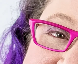

Hello! I need some help please! I took headshots for some people and when zoomed in Photoshop/Lightroom, the photos (6000x4000, 300dpi) look pixelated at 100%. I'm wondering if anyone knows why? Is this something normal that happens, is it the camera I used? I've attached a screenshot of what the photo looks like at 100% in Photoshop.
This is what I used for the photos that I hope helps!
Canon T6i
Sigma 18-35mm, 1.8

It looks like a digital noise.
What is your exposure settings?
^ This. It's not pixelated - look at her hair strands.

Looks like luminance noise.
Looks like high noise to me. What was your ISO set at?
i agree here. just looks like shooting well above 6400ISO. the catch-lights suggest a studio setting -- so imho there's a lot a user error going on. Unless those are dim continous lights and then that's why most photographers use strobes.
also we are looking at pixels here.... hence pixelated.

Hey, thanks for responding! I'm definitely new to this but the info for this photo is:
ISO 800
f/1.8
1/400 sec
Canon T6i
Sigma 10-35mm F1.8 Lens

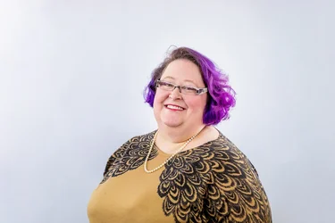

Thank you for responding and helping! For the lighting, I was using continual lighting. There were 2 soft boxes and 2 umbrellas that were used during this shoot. I've also attached the full picture to this message. I had to downsize it quite a bit but I hope that's enough information to help us understand the issue better!

Looked FINE as the full image area...but poor as a tiny, highly-cropped segment of the frame.
The possible reasons for converted RAW are:
1. Pulling exposure in pp.
2. Pulling smthng in tone/curve controls.
3. Turned off noise reduction module in RAW developing software.
Agree with above.
On the settings side, 1/400 sec is really fast on a max 35mm lens, Drop that to below 1/200 which will drop the ISO and lower the noise.
also, fill the frame with the subject so you dont waste pixels and have to crop-in.
