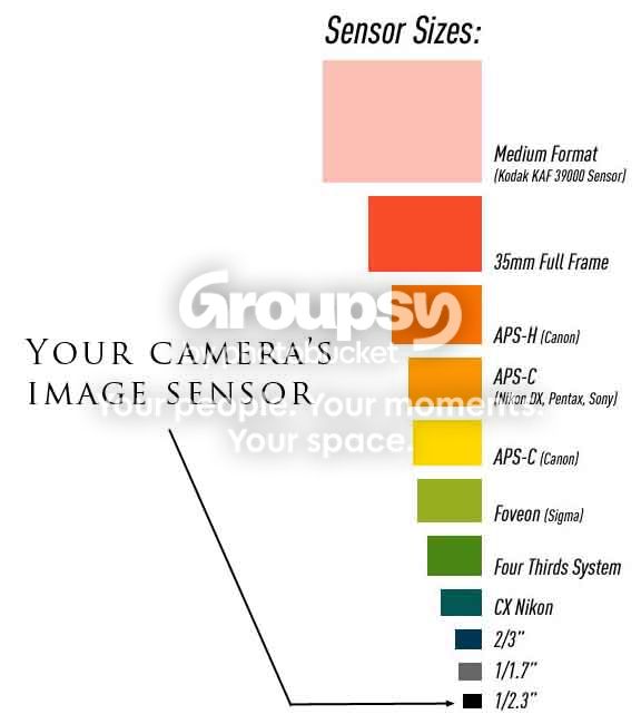

The very small size of a lens opening at f/22 is determined in large part by the very small size of the image sensor in your camera. The smaller the image sensor, the smaller the image circle that gets projected onto the image sensor.
Diffraction would be so severe anything approaching a reasonable degree of focus sharpness could not be achieved.
The smaller the image sensor, the more sensors that can be made on a single wafer of silicon, and the cheaper each sensor is to make. Which has a lot to do with how much your camera cost.

[IMAGE REMOVED]
Does posting image files that are not yours apply to non-photographed images...? Not trying to be a dingus, but it is strange to see a mod post an image directly that they didn't make themselves. As I understand it, the image is from: Buying a camera: everything you need to know | The Verge
Hopefully your response will clear up any future confusion. Thanks Keith!
[IMAGE REMOVED]
