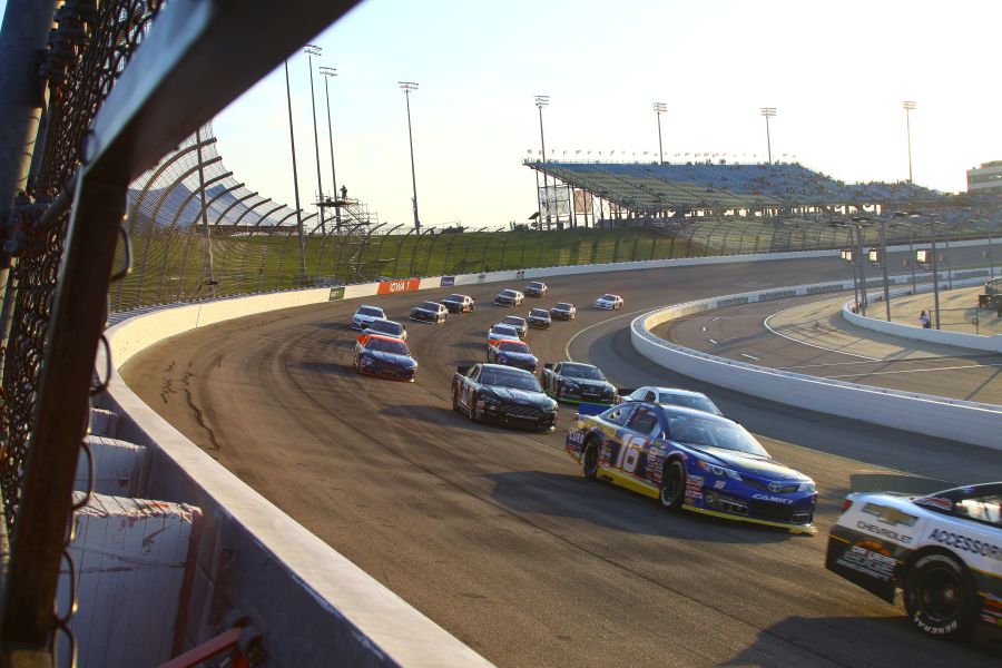

Just an example, I might have taken 40 images to get this one right. I'm sure you will get a more balanced setting and get many more good shots. But plan on taking many more than you need, because... it's only electrons, you can delete the bad ones.
ISO 100, 1/30, f/14 manual focus, manual exposure 100mm lens. Shot as JPG, sorry I don't do RAW because I need speed to capture speed.
The point isn't about how far out or extreme someone can go, but instead how panning and Manual settings put you in control. I only used manual focus because I had to catch the car coming out from behind the trees and nothing I own will catch sharp focus that fast. For swimming you are tracking, panning and following, you need auto focus.
The Sun was going down. The cars are moving at speed. If you can get your angles more straight on or 3/4 towards you, instead of straight to the side, you'll also have less blur.

Oops I'm on the wrong side of the shadows. Partial car is blurred, it's closer, but you can see how distance and angles can work in your favor also. Cars coming at the camera will have less relative motion to the camera.
