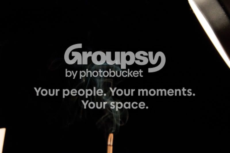

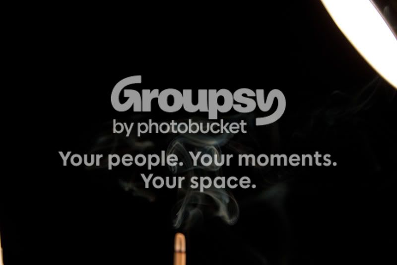

Photographing Smoke - right I've read and watched a number of clips on youtube on how to do this but after trying 3 times now and taking over a 100 shots ive lost the will....
Setup - Canon 500d 3-4 feet away from subject. Black back drop with 2million candle torch to one side (3 inch cover taped around the edge to stop light spilling on back drop) with a large reflector opposite, all pointing towards a box with a number of incense sticks burning. Shooting in manual at SS 160-250 and F8 - now for some reason the camera can barely pic up the smoke, even though its seriously lit up....i'm having to increase the ISO to around 1600-3200 to get any kind of pic, which as you can imagine is coming out very noisy. I'm also having to get the torch really close to the incense sticks which is making it even more difficult. I'm starting to think there's something wrong with the camera??
Any help really appreciated....i've attached a couple of the better pics without any editing...
I've always liked smoke photos. These are good, but you should define the smoke more in this photo. It feels a little to whispy and un-noticed, I know you mentioned that they are un-edited but these are just a few tips for the editing.
~ Jackson
I've never done these so this is a blind guess, but is there a lot of air movement in the room? Furnace on or people moving around?
No movement - it's like the camera cant pick up the light running through the smoke? I need to get the ISO down but haven't a clue how i can do this. The only other thing is to buy a remote speedlite and see if that helps????
Well judging by the incense it is out of focus which isnt helping. Maybe try stopping down some more, Im guessing you are using a tripod. The light may actually be a tad close ofr theat shot because we can see it in the photo, so the camera sees it and that will throw the camera off as well. Go here for good techniques for lighting Strobist do a search for smoke.
I had the same problem. I tried it first using a big halogen shop light (no idea on candle power.) Came out with some decent ones, not great though. I ended up decreasing the shutter speed so much the smoke took on an ethereal quality quite like the aurora borealis. I lightened them up QUITE a bit in PP.
Then I got a strobe and the whole thing got 1,000,000x easier. Smoke was crisp and I could bump up the speed to 1/200.

500D has a popup flash - might not be ideal, but pop it up and give it a try. Simply put if the smoke is not showing up then you've not got enough light on the subject for the camera to make an exposure. Remember cameras need a lot more light than our own eyes do in order to make an exposure (without taking the ISO very high), especially so as the shutter speed goes up and the aperture gets smaller.
A strobe it is then.......Lionsroar can you advise on a model which wont break the bank?? Thanks for the pointers.....
If you need to lower your ISO increase your light. That is all you can do with this situation
To get the ISO down you need a brighter light.
You can't use the popup flash because it will also light the background, which you don't want.
Focus on the end of a single stick of incense before you light it, and then put the camera in manual focus mode so the focus doesn't change (assumes the camera is on a tripod).
