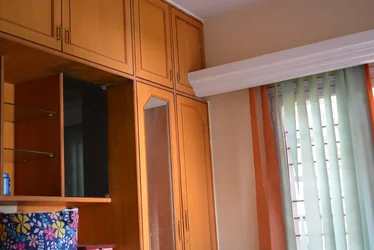

Hello Photographers,
Recently I purchased a Nikon D5200, and i was trying out different modes and just experimenting with it.
I found an anomaly with the pictures I took with and without flash.
The images that I took without flash are fine, but with flash turned on, there are strange lighting artifacts that pop up into the image.
I have attached 2 examples.
Is this normal ?
Is my camera defective ?
Is this because the lens are not clean ?
Thanks.

I'm obviously not seeing what you see. I don't see any artifacts, only reflections. You will certainly get reflections when using a flash, especially one that isn't diffused.

I am very new at this, so forgive my dumb questions, and incorrect use of words. May be it was reflections and not artifacts.
In the images where there is a mirror, i can see reflections. I get that now.
But in the images with the dart board, with the flash turned on, i see a ghostly haze right below the dart board. Now is that a reflection too ? it looks weird.

I saw the haze below the dart board as well and assumed it was a reflection from the glass in the door to the right. It could also be "Flare" from something else off to the side if you didn't have a lens hood on the lens.
Reflections when using a flash are commonplace and they aren't always obvious before the shot since they only appear during the pulse of light from the flash. The easiest way to eliminate or reduce most of them is to diffuse the flash. This can be done with the use of a soft-box or umbrella when using off-camera flash or a diffuser dome on the flash when using an on-camera speedlight. If you are just using the pop-up flash it is more difficult since the axis of the flash is so close to the axis of the lens, however a couple of layers of tissue held over the flash with a rubber band will help a great deal.

If you're talking about the bright line just under it that follows the curve of it, that's a reflection off the dart board's metal rim.

I get it now that the bright line following the dart board's metal rim is a reflection.
But the haze that i am referring to is actually about 1.5 cm below the dart board's rim.

That's the flash reflecting off the rim of the dartboard.

Above is a white ceiling - not an oil based paint - so it is dull and does not shine.
Below is a white marble floor, pock marked with dark colours - dull polish - should not reflect a lot of light.

It's not a question of WILL light reflect off of a surface, it always will. The question is how much it will reflect. If you can see the surface with your eyes then light is already reflecting from it. Matte surfaces and dark colors reflect less light than glossy surfaces and light colors, however they do still reflect. Also keep in mind that light reflecting from a surface will pick up a color cast from that surface. If you bounce a flash off of a red wall, for example, the light from the flash will take on a red cast.
