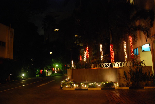

#1 - Full Auto - F3.5, Shutter 1/60, ISO 400, WB Auto (I don't know how to get the temp), In camera flash. Overall thought, the flash washes out the Christmas lights and you can't see anything beyond 15 yards or so.
DSC_3510 by DaveSG1970, on Flickr

#1: your camera chose 1/60 shutter speed. That is hardly slow enough for some indoor shooting, woefully inadeuqate for outdoor night-time shooting. I think the auto-mode assumes it can compensate for everything with the pop-up flash. But, the flash barely lit up the scene, though you sure can see all the reflective signs in the scene. It under-exposed the christmas lights.
