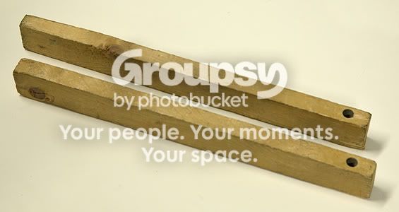

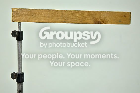

If you have to get by "on the cheap," its easily done. 25 years ago, I took two 14" pieces of 1x2s and drilled a hole in each. I use them with two Pic stands. I still use the same ones. They fit easily in the bag with my stands.
-Pete
