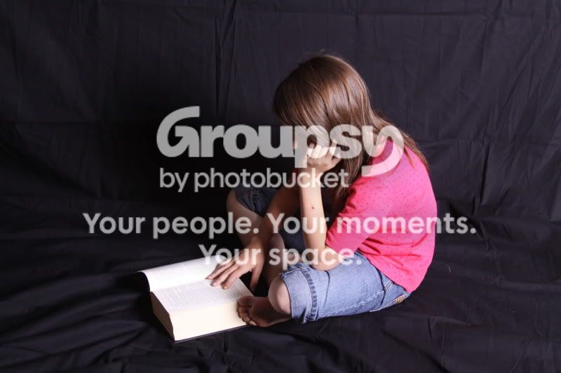

All the pink is splash from her top. If you keep your model further from the background (several feet) that won't happen. That's to bright a color of clothing for a portrait.
If you are going to use two lights, like Mike said set your lights to a ratio. Better still for portait quality light, put your 2nd lower powered light on the lens axis behind and above you. In this configuration it is a fill light. If you put the second light to the side, it is no longer fill, just a second light.
The problem becomes competing shadows on opposite sides of the models face (or mask, as it's sometimes called) in a 2 light setup as opposed to a main and fill light setup.

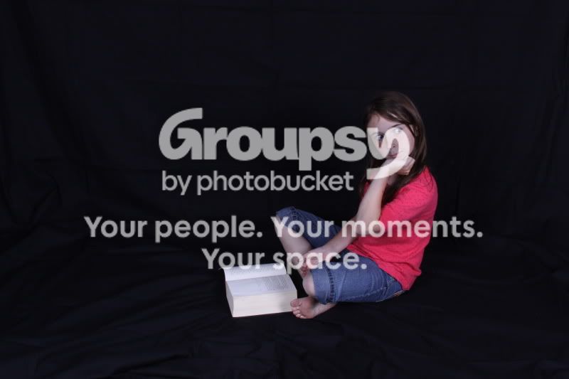

Im assuming the hair light will help seperate my subject/daughter from the backdrop. She kind of looks like she floating out in space. Although she has that look Im pretty sure the image up above looks better then the one below. Please keep in mind were just getting started or working out the kinks. My daughter is actually reading the book while I work on settings and take pictures. Its not a prop. LOL!!!
