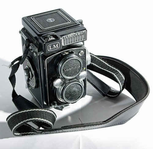

while not perfect was taken with two strobes and manual setting. The lighting could have been done with being diffused ( I didn't have one to hand to just had the flashes some distance away) and use paper for the background.
Incidently this was taken with a Pentax K200D using the kit lens.
I would certainly echo the advice above.
Firstly I would ask what lens your using and what lighting setup - investing the money into a better quality lens and a good lighting setup would do you a lot more than upgrading the camera body.
Camera bodies all operate under the same rules - though better quaility ones can let you get an impoved quality the biggest factors are the lens, lighting and user. If your getting bad results with the XTi there is a good chance that there is a flaw in your method or/and that your lens is of poorer quality - upgrading the body won't change any of this so you will still be having the same problems.
