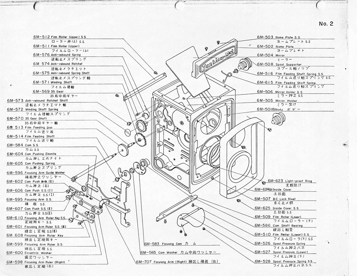

The link for the manual is one I already have, but thank you for the suggestion. This must have been owned by the same person, because from the pictures it includes a manual, flash and some other things you'd expect in a kit.
What I really need (and haven't found yet) are some exploded diagrams, videos, etc on the inner workings.
I have taken apart and restored some Yashica TLR's ... not that difficult to work with.
All of them had gummed up grease on the focus rack, though the cameras were still usable without having to CLA. Most of the ones that I got had a problem with the winding mechanism or the leaf shutter needed cleaning. All of them had dirty mirror ... it's easy to take the hood off to get at it.
