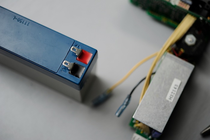

If you own a Quantum Turbo, replacement batteries only cost between $16-$20 each. If you have an older Turbo, and it isn't recycling like it used to, replacing the battery will make it recycle like new. To replace, remove the three screws on the exterior of the leather case, and carefully pull the electronics pack from the top. Pull the spade connectors off the terminals using a pair of insulated needle-nose pliers. WARNING! High-voltage inside! Be careful not to touch any conductors! If you don't feel up to it, a local BatteriesPlus will do the replacement for you at no charge if you buy the batteries there.
Quantum Turbo replacement battery: Power-Sonic PS-832 8V 3.2AH SLA with F1 terminals.
Yeah, I am gonna order a battery for my old Turbo. I bought it in '86, and t was dead in 1992. Oddly, I bought my Quantum Battery 1 the year before,in 1985, and it is STILL working on the original lead acid cell, even with about a decade's worth of neglect over fifteen years ago...I have no idea how that is even possible.

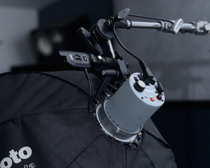

. . . I think I'm going with the Bowens Gemini 250R now instead. Why? Mainly because of Bowens' unique yoke design, making boom-mounting a breeze. All of my boom-mounted Dynalites have to be hung upside-down.
Here's a picture of my Dynalite Uni400 Jr./PlusX trigger, mounted upside-down on a Matthews boom:
About the Uni Jr 400...it it's too powerful, why not fit it with some neutral density material, rather than buy a whole new $499 monolight?
Yeah, I've done that in the past. In the meantime, I'm going to try to order another diffuser and baffle from Profoto to knock it down without having to fuss with gel and C-47s. What I was attempting to do in this whole exercise was to simplify my set-up, and reduce the number of components (i.e., potential "failure points"), so if I forget to change batteries in one trigger, or forget to bring some ND, the shoots still works. I'm still mulling this over since there's so many trade-offs to consider. The Einstein E640's extremely wide power range is very tempting, yet the Elinchom RX is nice because the Rotalux modifiers are so quick and easy to use. The Bowens makes inverted-mounting a breeze, and has excellent power controls . . . decision, decisions.

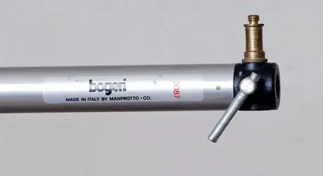

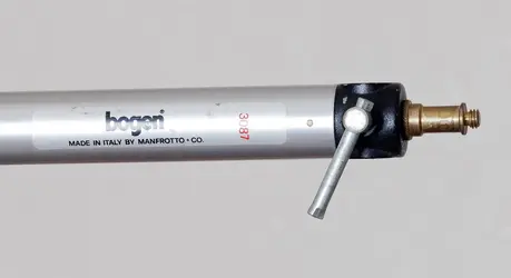

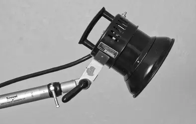

I use Speedotron Brown and Black line, and use Manfrotto boom arms, so I can put the mounting spigots into the boom arm either "on the pointy end-part", or "cross-shaft" mounted...maybe I am dense, but I do not quite understand why the Uni Jr. needs to be mounted upside-down...I have never had to mount a flash head upside down. What's the issue that necessitates this upside-down mounting?
And yeah, 50 W-s minimum....man...that's a lot of light sometimes. I like about 15 to 25 Watt-second for hair and rim lights in a typical 4-light setup. I am used to 15 W-s actually as my low-end. With an 11.5-inch 50 degree refelctor with silver interior, that necessitates a grid AND a mylar diffuser when aimed from around back, so, yeah, 50 W-s would be a PITA as the bottom end...
Maybe I'm doing it wrong, but top-hung seems to be the method which "spins" the least. If I mount the Dynalite directly onto the boom's 5/8" spud (oriented horizontally), it simply won't hold any tilt-angle (the Dynalite's baby screw just won't tighten with enough tension). Although I think I know what you mean by "cross-shaft," do you have a picture you can post of that? Thanks!
Okay, I know what you mean that the screw will not tighten with enough tension to hold the light. Maybe you could wrap some tape around the spud? That can work on a small screw that does not have a lot of bite. Plain masking tape has worked for me on that. Two or three wraps of m asking tape allows a weakish screw to bite down through the layers and kinda' "stick" in one spot. I had some old umbrella adapters that had the problem of weak screws that would not hold tension, so the tape-wrap on the spuds (spigots) worked great. The Speedo screws have a lot of gripping power, but the Bogen/Manfrotto boom's end allows longitudinal axis mounting of the spud (spigot) or cross-axis or "anti-twisting" mounting option, or "on top" or "on the bottom:" mounting of the spud (spigot).$DSC_8233_.webp$DSC_8234_.webp$DSC_8236_.webp$DSC_8238_.webp$DSC_8240_.webp$DSC_8241_.webp
Thanks for posting those! Yeah, the baby spud on my Matthews boom doesn't articulate like that. Cool!
