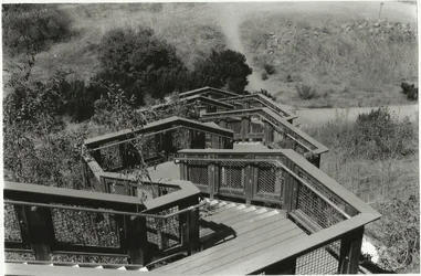

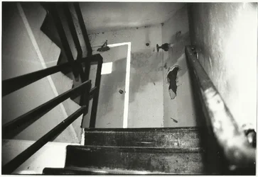

These are a few photos I just got done enlarging. What do you think?
Thanks
First shot, staircase, looks good to me. Did you bounced light off the wall ?
Second stairs, in the park, look to grayish, separation of tones is low, green filter would be helpful. Or filter in the color of the stairs. It simply lacks any brilliance.

Thanks Timor. First shot was not bounced flash. I just used the standard flip-up flash. I can probably just burn in that right corner a few more seconds. I used a #4 contrast filter on the enlarger, and it darkens rather quickly with that filter. Maybe I'll switch it to a #0 and burn that side in on Friday.
The second photo I used a #2 1/2 contrast filter. Maybe I'll switch to the #2 filter on Friday. Maybe that'll help it out a little?
I very often burn with softer filter especially hard highlights. In your case it should help a lot. With the second photo I think you should go up to #3 1/2 to increase the contrast.
I was planning to go into the darkroom today but they closed it up for the semester. :( Oh well. I got my final project back and scanned/posted them up if your interested in seeing them. Titled: Abandoned. I got a B+. Def after seeing the stairway picture next to the others, I should've used at least #3-1/2 contrast filters on all of them. They look so flat compared to the stairway picture. Oh well, it's a learning process. Can't wait to learn digital now!
