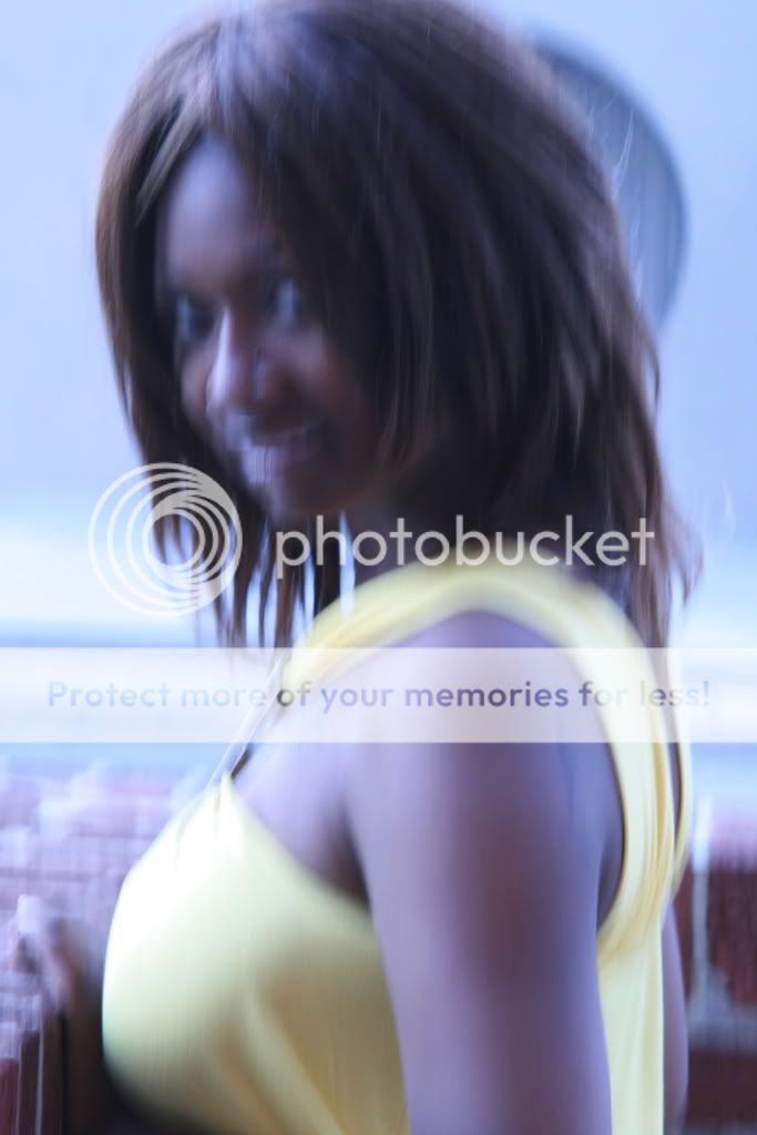

Hi I am a new photographer still learning the basics somewhat, my question is how can I reduce camera shake without using a tripod while shooting portrait shots on location on the go. I shoot with with a canon XTI and have noticed when trying to shoot faster around my subject most shots come out blurry my lens is the canon 28-90 but is not equiped with IS

Your EXIF data (thanks for posting a photo! :))
Camera Make: Canon
Camera Model: Canon EOS DIGITAL REBEL XTi
Image Date: 2008:05:25 09:09:44
Flash Used: No
Focal Length: 90.0mm
Exposure Time: 0.077 s (1/13)
Aperture: f/11.0
ISO equiv: 100
Exposure: aperture priority (semi-auto)
Basically that's way too slow of a shutter speed to be able to handhold a shot without hand shake blur at 90mm. The reciprocal rule says you'll generally need at least "1/focal length" for your shutter speed, so about 1/90s in this case. For portraits feel free to shoot the lens wide open at f/5.6. That's two stops and would take you up to about 1/60s, still a bit slow. Next you crank up the ISO by 1 or 2 stops to either 200 or 400. That'll get you to either 1/125s or 1/250s, both of which should be plenty for hand holding ability and for a subject that's posing and knows to hold still.

He`s taking pics at F/11. By bringing that down to F/4 to F/8, his shutter speed will increase dramatically. If its still too slow, increase lighting (flash) and increase shutter speed.

The shot that you posted was approximately a tenth of a second at f/11. Much too slow for hand-holding. Try 1/60 second or even 1/125. Naturally, you'll need to open the aperture to compensate.
