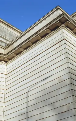

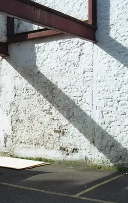

Hello!
I hope you guys can help.
I have recently purchased a Canon A1 with a 50mm FD 1.8 in pretty much mint condition it seems.
I have had three rolls back from the camera and just nothing seems to be sharp at all.
I’m just wondering if there is anything wrong with the camera or the lens at all? As the photos are nowhere near the sample images I have seen for this camera and lens.
What could the possible issues be?
I’m sure focusing could be one of the issues, but surely there would be at least something actually fully in focus in the photos if that was the case.
I have attached some sample images so you can see, but if you could help me it would be incredible as I’m not quite sure what to do.
All of the images were shot in Kodak Colourplus 200
Thanks in advance!
C7C2EC7F-96EB-40F0-AC53-02AF9A48014E.webp 92658CBD-18F5-40D7-8063-B765E74477CA.webp 96166D8C-E60F-4FCC-AB34-4EC7B94C317F.webp FAE79305-F01F-4C76-B88A-59115185C2A8.webp
I do not see an apparent "sharpness" issue with the images you have shown. It is not easy to validate this as we cannot see the actual negative. You should view the neg with a good loupe to verify.

Thanks for replying.
I never go below 1/60 and usually shoot at 1/250, so I’m not sure why it isn’t sharp.
I usually shoot at an aperture as high as possible, never really shooting at the low end.
Could this be some sort of faulty lens issue do you know?
Is there also a difference in sharpness between the 1.8 and 1.4?
The Canon FD 50mm f/1.8 is not the highest IQ lens ... it is good but the f/1.4 is much better, especially wide open.
Thank you for replying.
What do you mean by highest IQ?
I’m wondering if it is a lens issue of some sort.
I recently purchased the FD 35mm F3.5 and it’s on the way, so hopefully just using another lens on a roll I’ll be able to see if there is a difference.
I don't see a lens issue. That lens is adequately sharp, I use to use one a a Canon T70 . I suspect the quality of the scan first. Unless your rock steady, I would try and stay above 1/125s. With that lens, usually f/8 produces the sharpest output and fidelity. Things are normally very good from f/2.8 up to f/11 and then diffraction starts to soften things after f/11.
Kodak color plus is decent but doesn't scream sharpness as a film stock for what's its worth.
Load a roll and shoot a brick wall at all the apertures, mounted on a tripod. Your manual focus skill could be rusty as well. All that being said, I still think the scan is probably limiting some detail. I use a V800 and with 135 film, everything needs to be spot on in the process to get a decent result. Decent is relative when it comes to 135 and a flat bed, a dedicated 135 scanner will produce better results. Labs offer various scan qualities and it really makes a difference. So scanning is a rabbit hole with 135. I am not a pixel peeper and sharpness has never been a primary concern for me when it comes to the image. Sharpness is last on the list but missing focus usually will rear its ugly head. I don't see that in these. You can reverse that 50 and use it as a loupe to check your negatives in a pinch.
