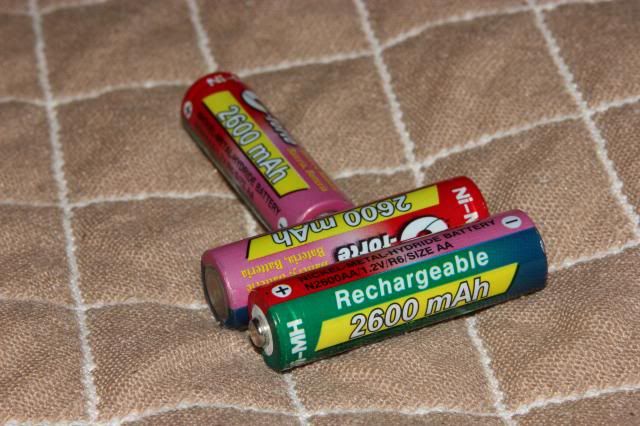

Here are a few photos I took as examples:
Lense: Canon EF 24-70mm f/2.8L II USM (this one is I bought very recently and works marvelous.)
Shutter speed: 1/125
F/2.8
ISO 100
F/8.0
ISO 100
F/16
ISO 100
F/22
ISO 100
Like you guys can see no problem with Canon EF 24-70mm f/2.8L II USM. All seems just fine.

Tyler's correct about looking at the EXIF information--it can help diagnose a lot of problem issues. One possible issue could be that the lens diaphragm is malfunctioning. With your zoom lens, the overall level of exposure is quite consistent, and with the 100mm macro, the exposures vary wildly...which might indicate a problem with the diaphragm not stopping down properly each and every time.
