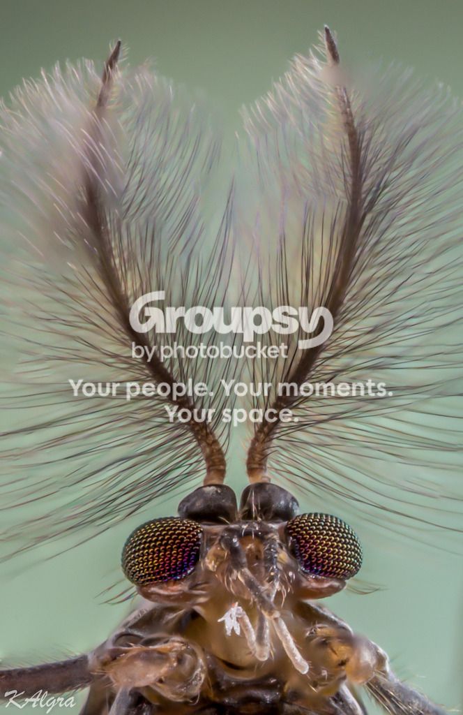

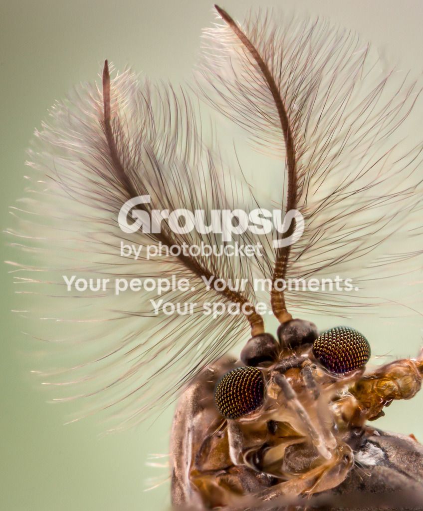

These are two of the first stacked images I have tried. They didnt turn out so hot but I guess for a first try not completely terrible. I obviously missed focus in a few areas and photoshop didnt stack the antennas well at all or maybe I just moved things to much each time I adjust the focus rail. Can anyone tell me if Zerene stacker or the other one that starts with an H is all that much better over just using PS? I used a cheap $70 kiwi focus rail which I hope will get me by for awhile until I save enough for a stackshot.
Zerine Stacker - Helicon Focus - Combine ZP (this one is legally free) - Photoshop.
I think there are a few other and astro photography has a few although I think they work very differently but I've not tried them.
In general each one works differently and most even have a few different modes within them and settings you can adjust (eg sometimes removing a frame if there is sufficient overlap in the shots either side can improve results). In most areas of editing changing programs for the same function results in marginal gains - in the case of focus stacking it can be the difference between a fail and a success and is one area where it is recommended to have access to several software options. Because they each work a little differently the properties that they work best with in a series of shots varies; however you cannot shoot to those properties so you can't shoot with a style for a specific program.
Try them all and play around is the best advice I can give; the investment in stacking is significant at the camera end so having several software options incase your favoured one of choice fails is good.
